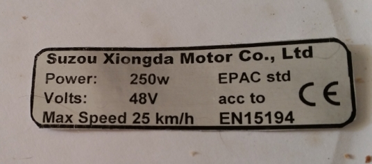

I'd remove any sticker that mentions speed or 350w. If the motor is stamped, it might be a good idea to stick a label over the top of it. It's pretty easy to make your own using this method:
To make the label you need a laser printer or photocopier. 2" wide aluminium tape (DIY shop) and wide selotape.
Design the label on your PC
Print it on normal paper
Fix the aluminium tape directly over the print by tacking it in place with selotape just holding its edges. Leave the backing on for now.
Put it back in the printer and print again. Same if you're using a photocopier.
Now the aluminium should be printed.
Remove it from the paper
Cover the whole thing with wide selotape being careful not to get creases.
Cut to size
Peel off backing and stick on motor.
You can do the same to make a frame label - cheaper than those ones on Ebay
