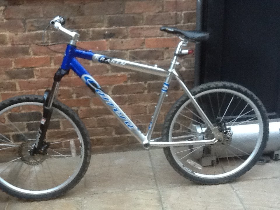

Bafang 250w mid drive upgrade.
Maybe I've missed this as it may of already been covered. But is it worth me getting the Bafang USB lead..
And can the controller be programmed to do more..
This is my bike almost ready for the motor tobe fitted I've already purchased the gear sensor lead..image.jpeg.fe8efa0a5abab6e2597de3e499241acf.jpeg
