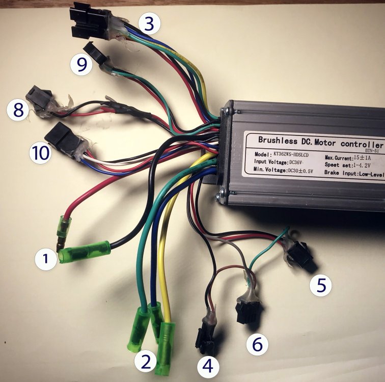

Screenshot2018-10-28at12_01_40.thumb.png.ad36121928c5a41cba8458aaca2ab5be.png As you know your batteries, can you tell me what this 3 wire JST connector with blue green and red wires would be doing connecting to the three outputs on my battery between positive and negative? This picture is the behind where the battery connects too and holds the controller unit.
[ATTACH=full]27446[/ATTACH] As you know your batteries, can you tell me what this 3 wire JST connector with blue green and red wires would be doing connecting to the three outputs on my battery between positive and negative? This picture is the behind where the battery connects too and holds the controller unit.
It will be probably be sending state of charge or other battery information to the controller. What does it plug into?
I only wish I knew. I am trying to re connect my controller and the controller does not seem to have an inputs for it. Yes, I know I should have marked all the cables before unclipping them.
See attached charts to follow my wiring plan.
And I don't seem to have a Male three pin JST connector spare from the controller for item (D)
5 and 8 are still vacant, but they are female and I am working on these being for rear brake sensor (G) and Thumb throttle (H). Not sure which way round for those two.
I think that 8 must be the brake, as the cables did split into two, and then one seem to be cut off. I am guessing that this is because there is a King Meter rear brake sensor on the rear brake and nothing on the front. If they had used brake cut outs on the handle bar brakes levers, there would have been a second connector from there.
