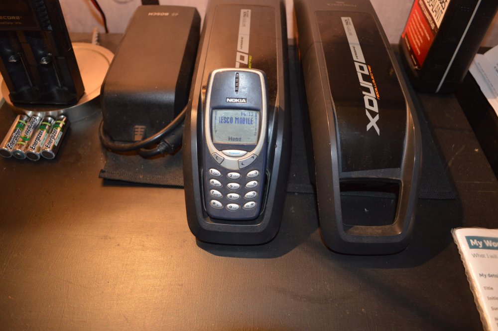

So much for my first venture into smartphones, I've grafted the nano sim back into a big sim and I'm back with my old clamshell :(
