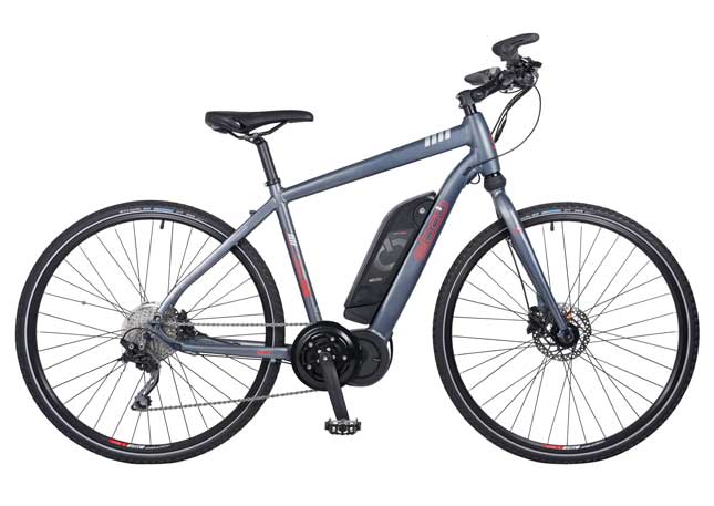

Ebco USR55
Ha, full mudguards with stays & a chain cover:).
Going a little OT here...
You must be looking at the wrong bike... £1099 (deduct your employer discount?)
So I was, but still a thing of beauty.
199087?$cr_main$
The Ebco hybrid is rigid fork so a no, but the MTB is suspension.

The Ebco USR-55 has TransX headstock suspension. It gives about 30mm travel, which I'm finding perfectly fine on road and trails. Yes, a NEX fork with 63mm and lockout (as my MaxDrive bike has) might have been a little better, but my view is you can't be too choosy given it's a decent crank drive motor with 10-speed Shimano Deore gearing and hydraulic brakes for a tad over a grand. The Ebco MH-5 MTB version has fuller Suntour forks, but compromises on other parts, given it is the same price.
Shows how out of touch I am. I didn't know there was such a thing. All I need is something to dampen the impact so this is an option. Thanks.

There's nothing non-standard about a TransX M16 GT mid-drive motor, except nobody on this forum knows much about it. And that might well be because no-one has had any issues with it!
Given Raleigh, Diamondback, Ebco and a host of European and American makers have been using it for years (since 2014?), and there aren't many - if any - problems of note found if you Google extensively suggests it can't be bad at all. Even EBR loves this motor on comparable iZip bikes!
As with all the common mid-drive motors, if it fails, it's a dealer issue. But it comes with a comprehensive 2-year warranty and dealer plug-in Can-Bus diagnostics, so, no, I'm not concerned. And at a grand-ish? Where's the problem?
If mine fails, I'll be sure to shout about it here and eat humble pie.
I was just going to say, where in the UK can you get spare parts? I guess you can't unless you know an Ebco dealer. I can guarantee that Halfords don't stock any spare parts for that bike. They don't even stock parts for their own brand.
First, you'd need to diagnose what's wrong with the bike and which parts you need. How are you going to do that without CANbus equipment? Which dealers have that? I've never found one yet, though I know they exist. I bet Halfords don't have the equipment.
Even if you could get parts today, the chance of finding them in the future for such a niche product won't be very high.
They're selling off those bikes for a reason. You'll see that the replacement model already has a different motor. I wonder why?

Well, Ebco have their head office in Warwickshire with their own TranzX trained engineer. I'd think that'd be a sure bet for getting future spare parts in the UK.
The "Can-Bus equipment" comprises no more than a standard PC laptop with a mini-USB to USB cable to connect the bike. The diagnostics software can be downloaded from TranzX own web-site for registered dealers. A dealer I half-know showed it to me, the tests it runs, and the reports it produces. Ebco have 130 dealers in the UK. And Raleigh dealers have access to the same system too. There's a TranzX youtube video showing it and how it works. The manual contains all the error codes that might appear on the display in the event of any fault.
That might be a possibility. But TranzX have their main European HQ in Bad Nauheim Germany. That's no different to Bosch owners, having to send/source replacement motors/parts from Germany, is it?
These bikes are made in China, and I'd guess the new series will be made elsewhere where there isn't an EU import tariff of 83% imposed... just like most other importers now.
I wonder why too, but given the near total absence of any complaints about it, I doubt it's to do with reliability or service. I'd suspect either issues of supply, or maybe it's just easier/more mark-up in selling an e-bike with a brand named motor people more easily associate with/aspire too?
Looking at the link Woosh supplied, a blind monkey with a pozidrive and a ratchet could drop and change that motor in 1/2 hour. So, once outside your two year warranty, a motor (with inbuilt controller) is <£400, a 400Wh battery £270, a display £60. This ebike is already £500 below normal retail, so even if the worst were to happen in a few years time, this isn't silly "remortgage your house" Bosch/Yamaha money is it? I'll wait for the flak...
