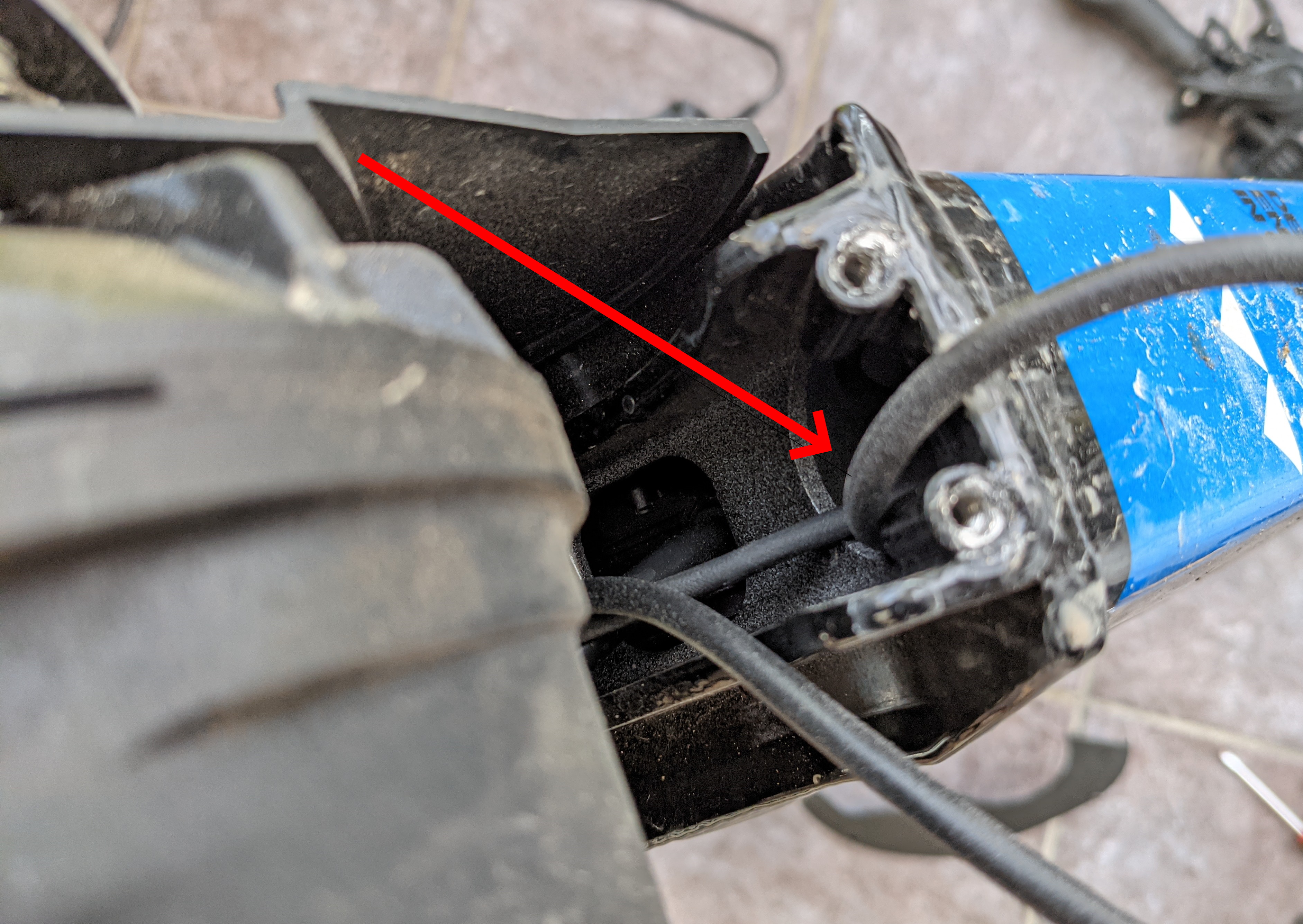

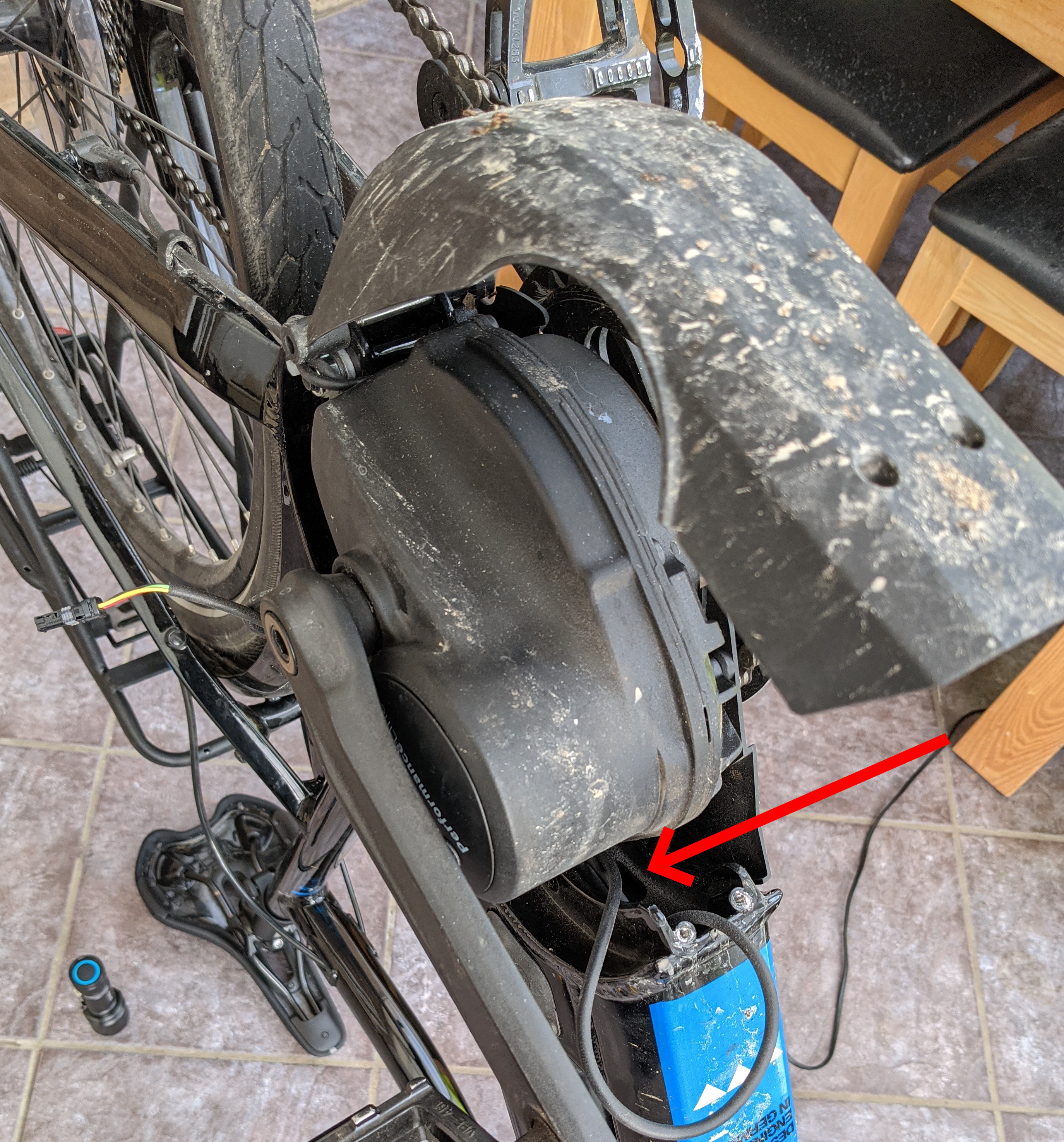

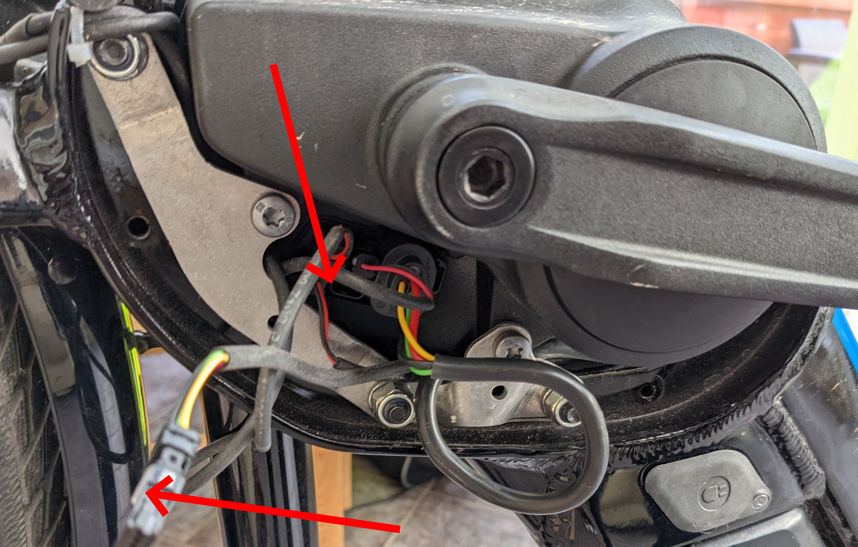

Interesting development, I took the plastic housing off to see what the job looks like, and to my untrained eye, I don't need to even touch the motor mounts, I can access the holes the wires come out of, in-situ, in my Haibike.
Anyone confirm?
PXL_20211117_145146692.thumb.jpg.9094b59e6352f493f9ae05220fb9cbea.jpgPXL_20211117_145154396.thumb.jpg.59b3be1ed7a646f2ce55904edbf74c74.jpgPXL_20211117_145214273.thumb.jpg.f5bc0fb94360919d30a890deda298c8d.jpg
Mines a Cube so not the same but by the pictures it looks like it could be quite an easy job. Probably get it done in 10 minutes ;)
Turns out the problem was not getting to the down tube, but getting the old lead out, I have left it in situ and ran the new one alongside. And round the motor, not under (there is plenty of room behind the plastic housing to go around rather than under, so go knows why haibike ran the cable there)
just take out 2 of the motor bolts and then swing the motor out the way and can then remove the old cable.
I did that in the end. I really wanted to avoid touching motor bolts, due to aligntment issues and torque settings. In the end, it's all assembled, I just need to tighten the Torx T30 screws when my amazon torque wrench arrives tomorrow (mine didn't go low enough), and buying a cycle torque wrench was only £24, still much cheaper than getting some trainee at my local Bosch centre, who didn't know anything about what the job entailed, or even if it's something they could do charging me £50 an hour, or part thereof. I now own a cycle level 5nm to 25nm torque wrench and also know the work has been done correctly :)
