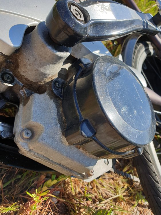

Thanks . I think it is the Panasonic, from other info on the system, although it is branded Derby. I will send photos in the morning. It does have 3 power modes.

Kalkhoff have used several different motors and generations of them , so only comparing exactly the same thing would help. To help I need to know exactly if you have the Panasonic unit that they used from November 2007, so here's two photos of one from low on the left, without and with chainwheel. Is yours exactly the same in every detail?
[ATTACH type=full" alt="New Left hand side.jpg]35640[/ATTACH]
[ATTACH type=full" alt="crankcase.jpg]35641[/ATTACH]
This does look the same as mine, but am uploading similar photos. I am reasonably confident that there is not enough power being delivered. Its deceptive, because starting off downhill, its a heavy bike so does take off quickly, but then does die given any sort of slope up needing a lot of pedal input. The 3 power settings do not seem to make a lot of difference. I could get it to Bristol if there is an expert there? Thanks again.
Yes, that is the same 2007 model Panasonic unit. Derby Cycles gmbh is German parent manufacturing company of many brands, including the Kalkhoff name.
