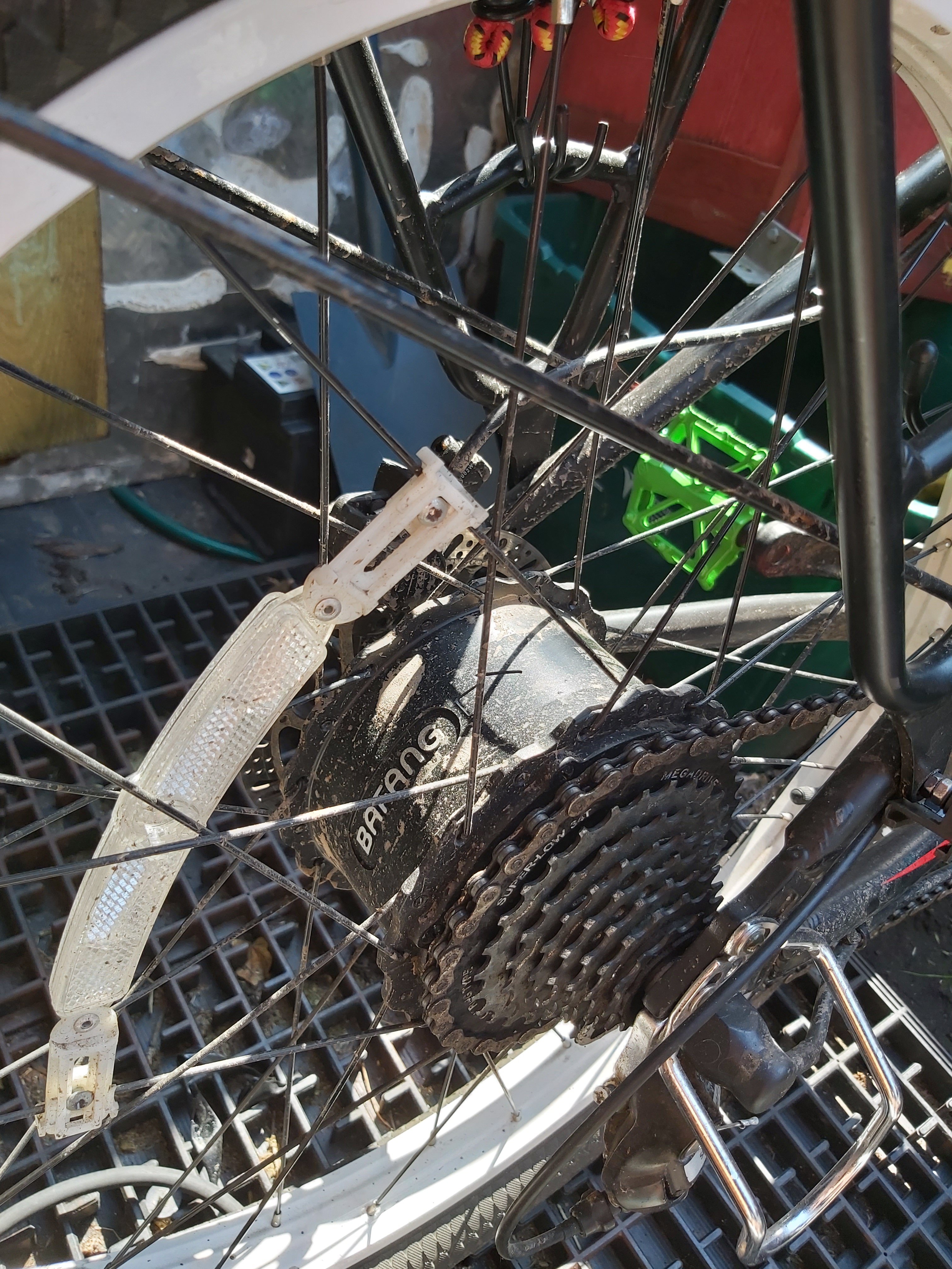

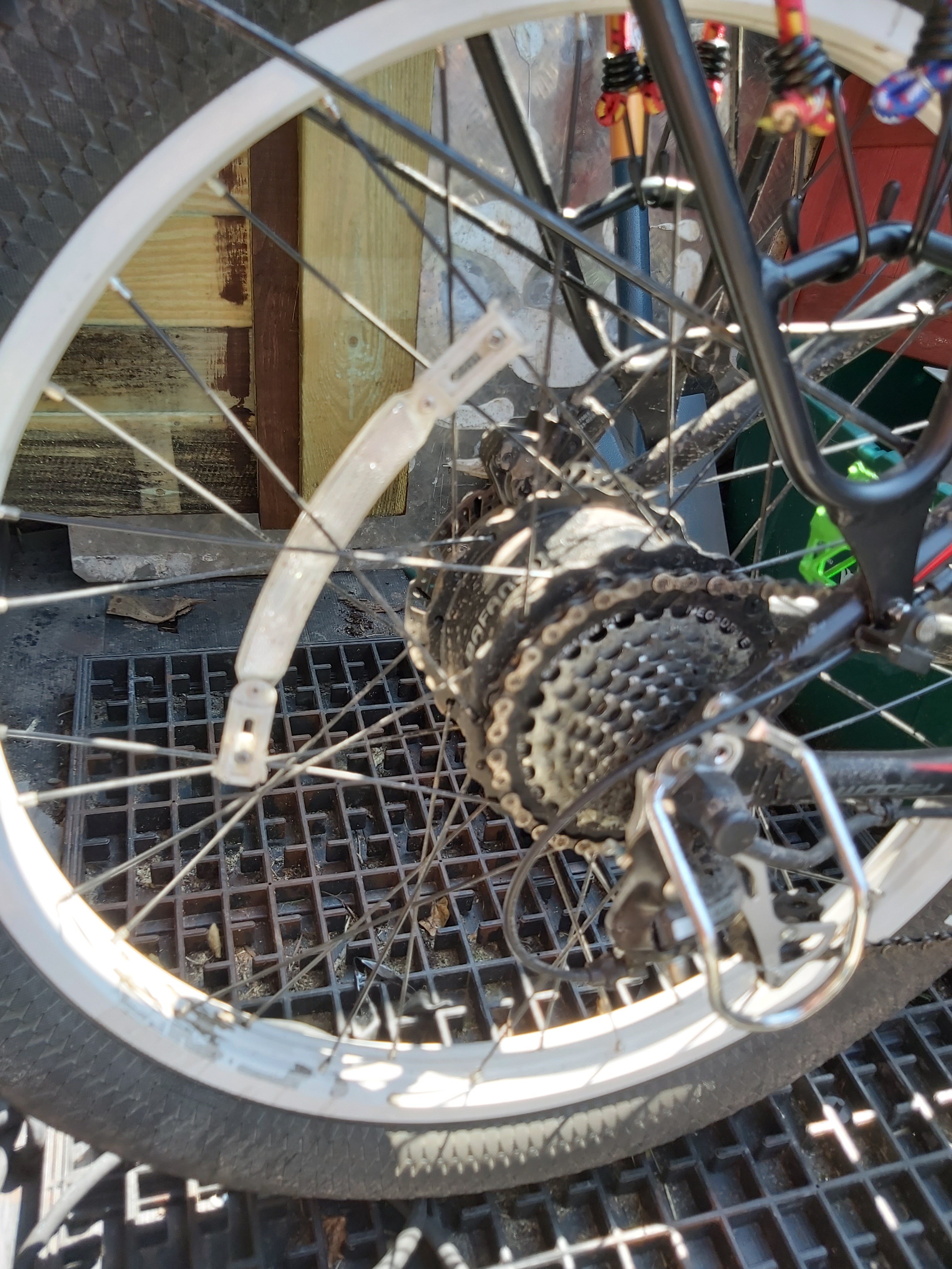

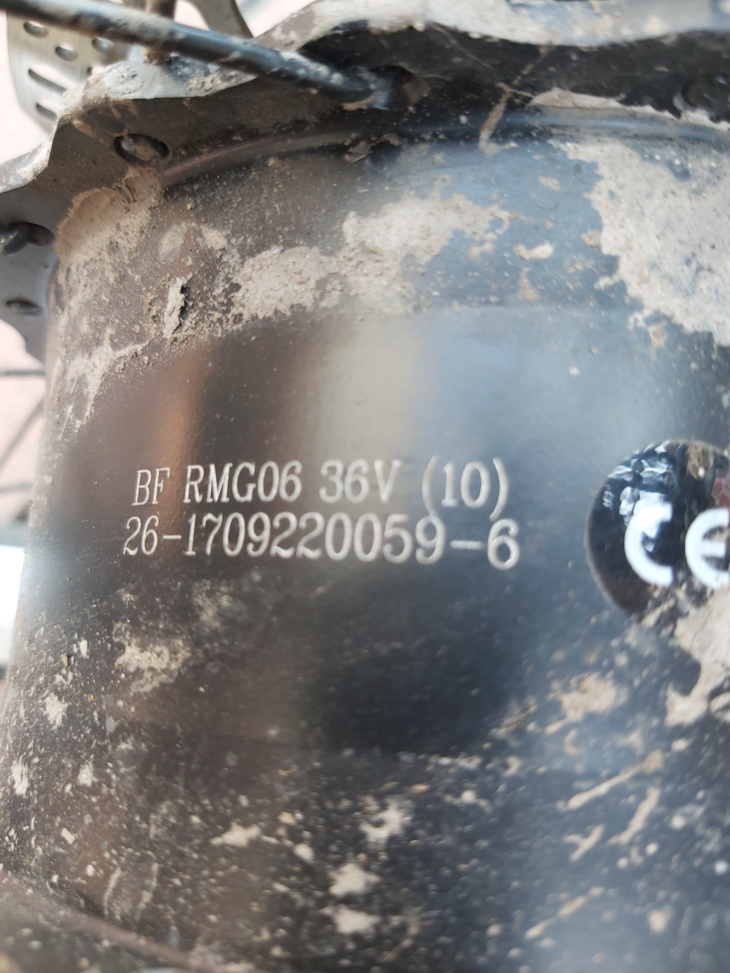

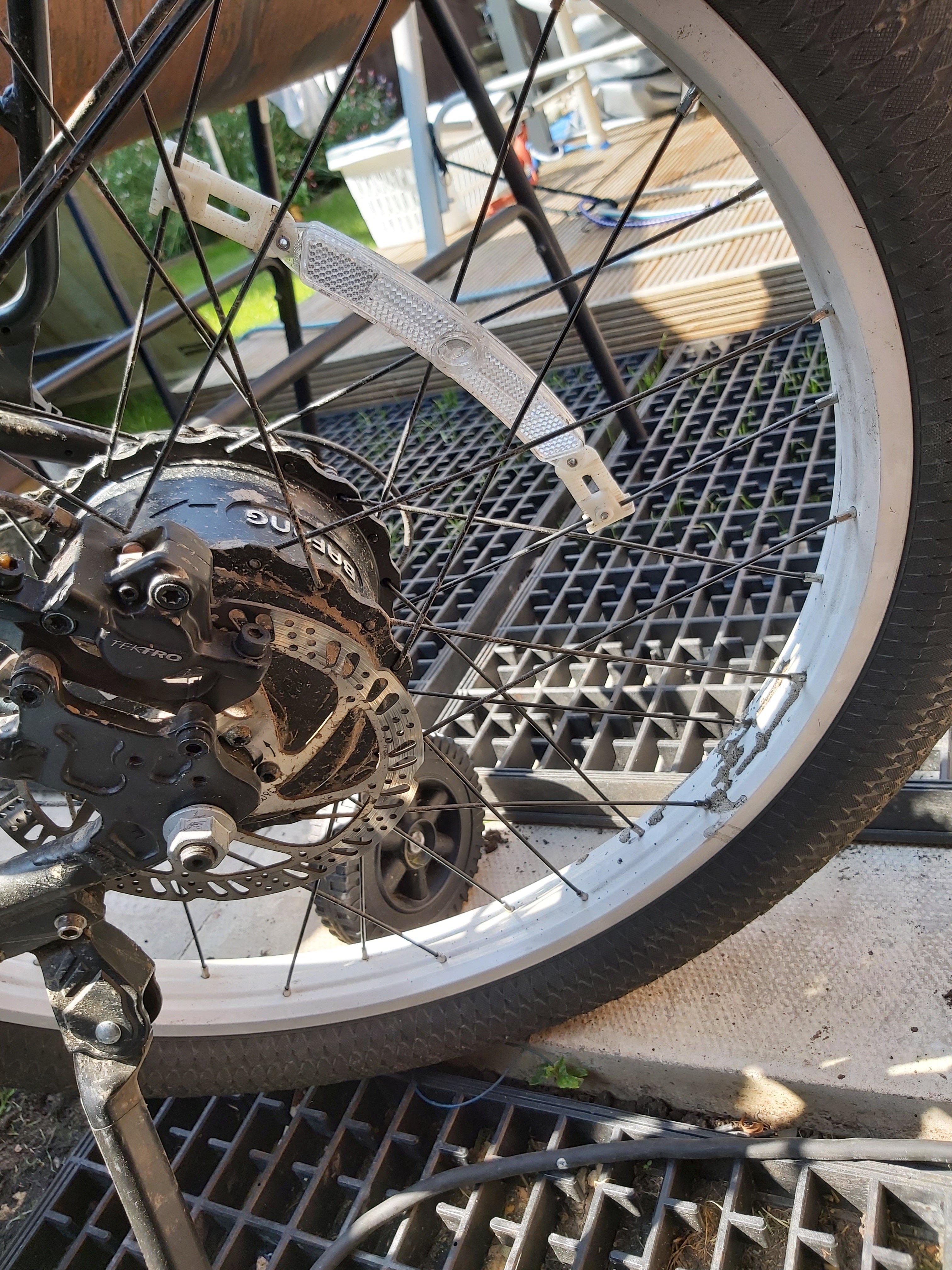

That's a code 10, which is quite fast. It equates to 315 rpm at 36v, which is 23 mph in a 26" wheel. Can you confirm which size wheel its in and show a photo of the whole motor from both sides?
Yes it's quite fast for 250w. And yes its on a 26"x3" wheel/ tyre. Thanks for the assist. Hope these photos help.
