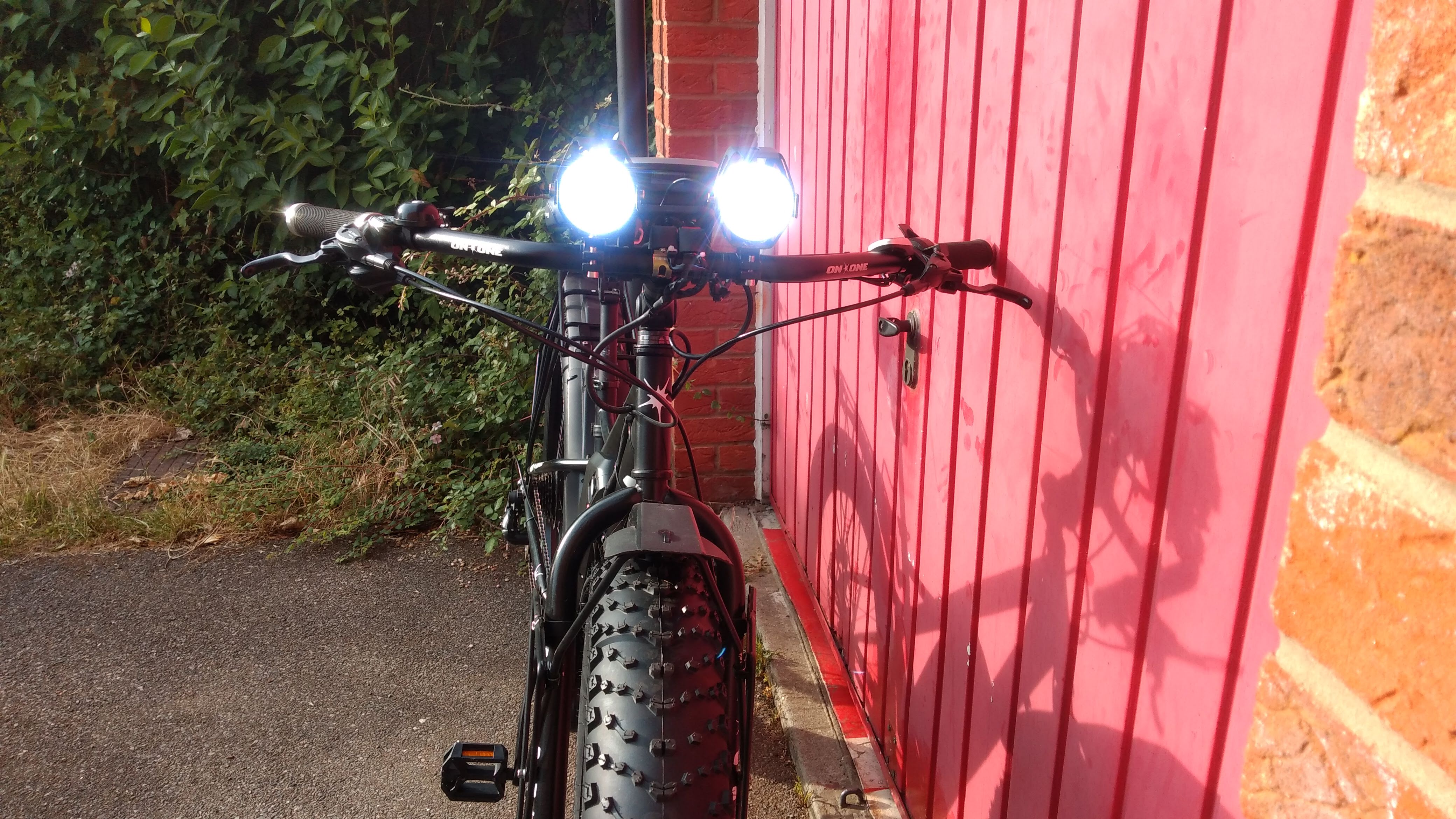

Very limited current and a risk to the controller even tried a relay and high output led up to 70v in with a cree driver just hated the extra cables
[ATTACH type=full" alt="IMG_20200614_183857.jpg]36878[/ATTACH]
Wow! Nice bike too!

That's if it is a low current supply - Peter.Cs lights look like they were drawing a bit - would be nice to know what the supply is rated at.
The high current cree lights in the pic are powered via a relay that connects to the tsdz2 light cable then fused to the battery [also needs diode across the coil ]
Standard output <500ma it is not fused and unhappy at one 6 v led front light and one dim rear light , check out ebay for front and rear set ok in a city with street lights but no good in the dark
Ah I see why using a relay is a good idea then...and looking at the voltage of ebike versions of lights, some stepdown required :/
The one in the pic had cree led drivers, and worked 36v -70v with a day light halo and high beam
Hi Swizz, I have simply used the lighting cable that came with my 48v TongSheng kit. The speed sensor had a "Y" dual socket so plugged the sensor into the one and the lighting cable into the other. Bought some low cost front & rear lights and it all works a treat . The VCLD5 provides DRL & full output all powered from the main battery. I only needed the lights for safety reasons and to assist on darker evenings, definitely NOT dark forest trails!! Lights cost me around £25 and I did add some extra support to strengthen the spade connectors on the front light and the push-fit connectors on the rear by applying some silicon sealant and insulation tape. I am not sure whether I should of added a fuse as I feel I have sufficiently strengthened the cabling to avoid potential shorting and risk damage to the controller. I am sure someone will be along shortly to correct my errors.
