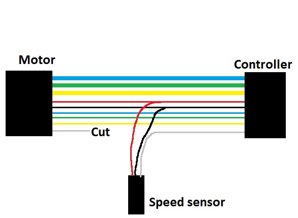

February 27, 20215 yr There are two ways to get more speed. You can either buy all new electrics other than battery and motor (about £80) and wire them in or you can do the speed sensor dodge. The new controller will give the option of more power too, but I don't know if the 17A or 20A ones fit in the space provided. You'd need to tell us how big the space is. The speed sensor dodge is something you can do on most hub-motored bikes. The speed signal comes along the white wire in the motor cable. You get an external speed sensor and splice it into a short motor extension cable. You put a magnet on the inside of the left side pedal spindle and fix the sensor anywhere where the magnet will pass close to it. The controller will then see the speed of the pedal, which would be around 60 rpm instead of the wheel speed of about 190 rpm at 15 mph. Obviously, the speed display would be wrong too. If you just want more power, you might be able to solder the shunt in the controller. Use Google to search the forum how to do that. Some modern controllers have solid state shunts, which are a bit harder to deal with, but still possible.
