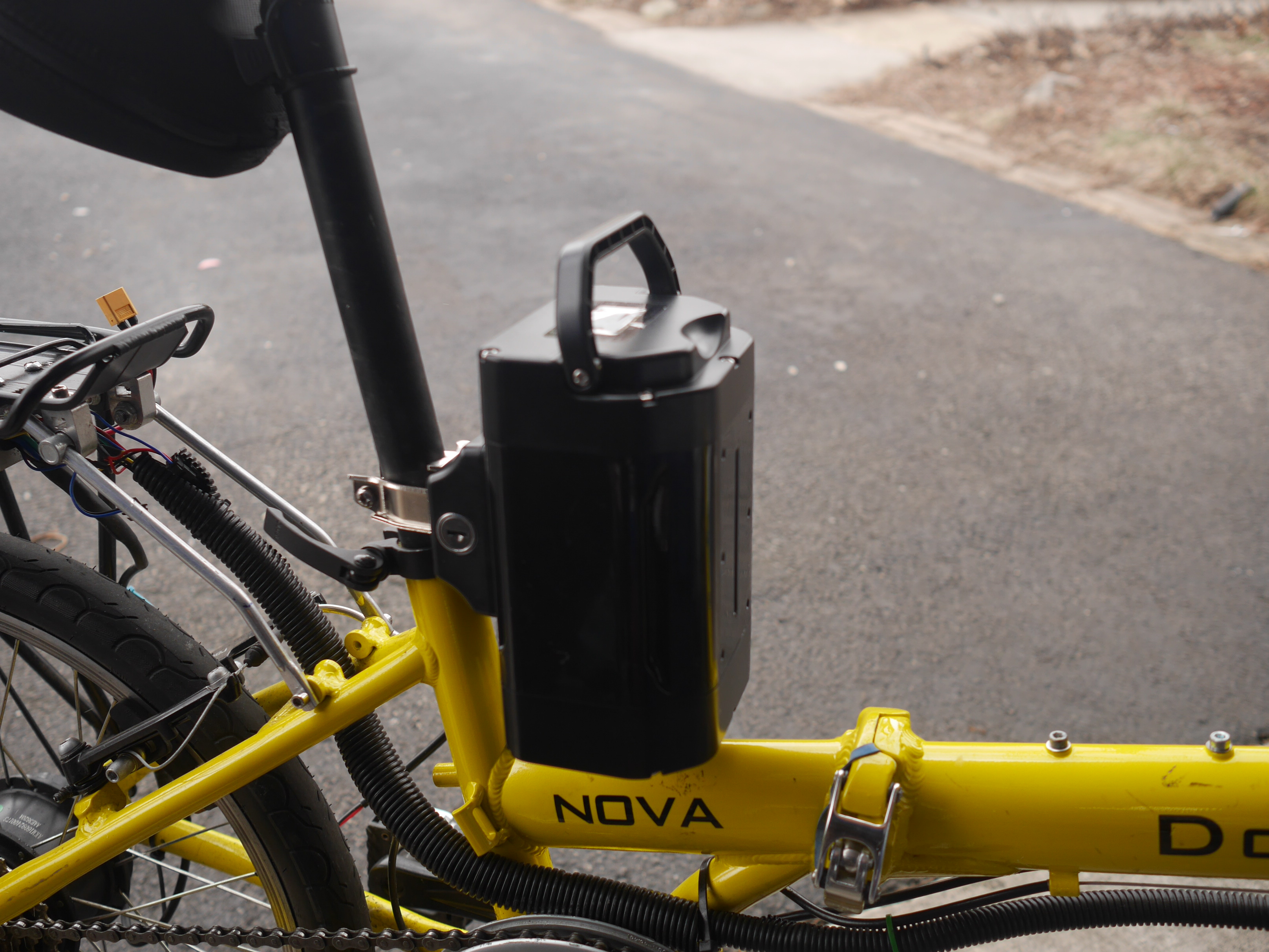

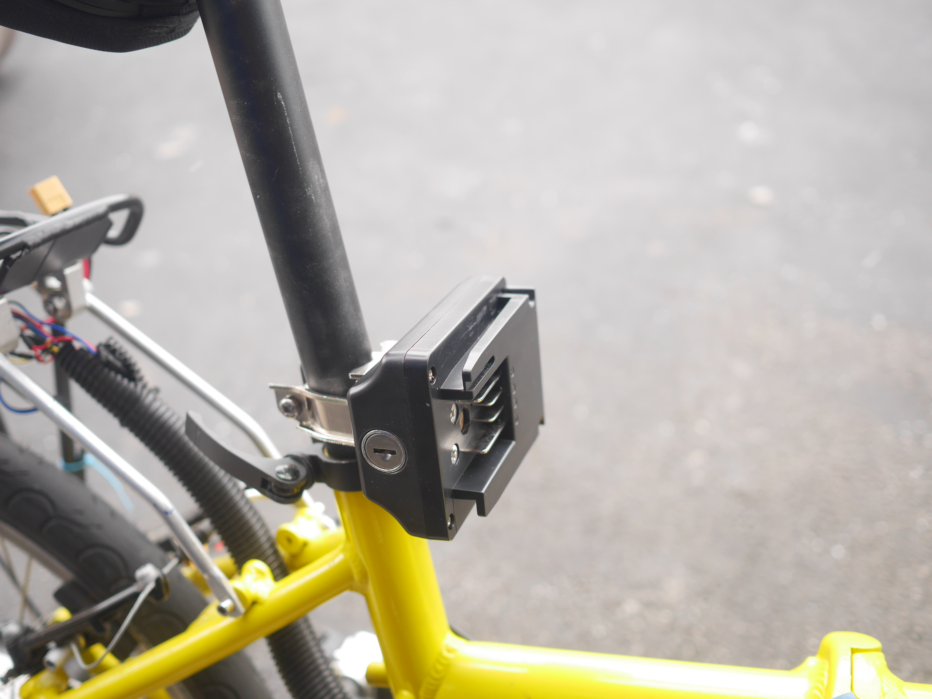

I have one of these. It's a 10S-3P. I was afraid to mount it on the seat post. The bracket didn't look up to the task of daily riding.
P1630611.thumb.JPG.576823a8500f13df5fef2bbcaa93093d.JPG P1630606.thumb.JPG.07bbadbab8d8924eed20a95bd6d3c966.JPG
I drilled a hole in the case and ran a XT60 connector out of the battery. I removed the bracket hardware from the pack, and I lay it in a battery bag on the rear rack, which all my bikes have,

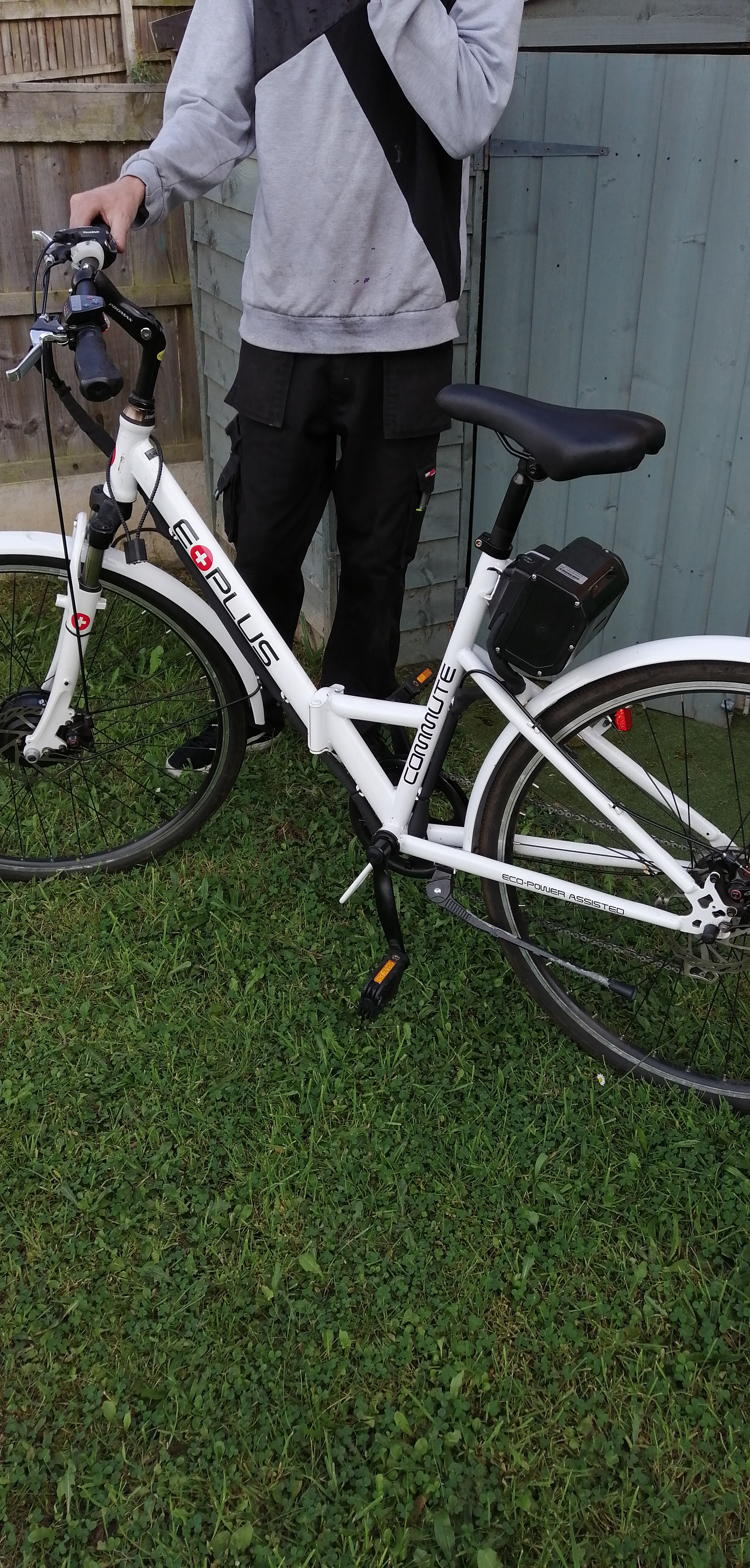

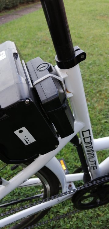

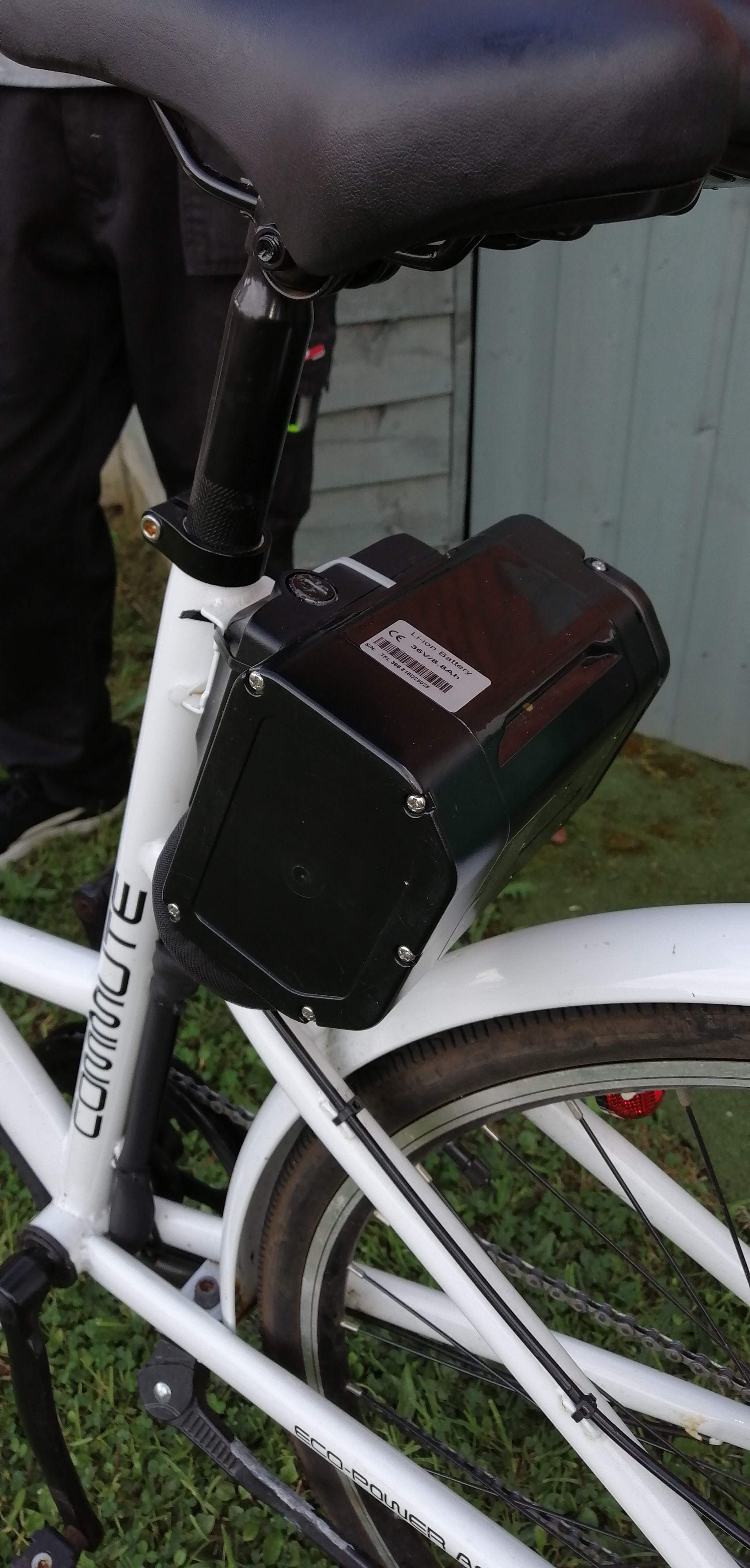

Thanks for the reply guys I've asked to eBay so about the prog battery they said you can't put it inside I'm talking to control is about 4 inches long 1/2 inches and 2 inches wide as you can see I brought a ebike from Argos a year ago for my missus and as you can see from the pictures it looks similar to yours are it but behind the casing old to little ebike controller is now all snapped I tried to get into contact with Argos and they can't do nothing about it and I cannot find the replacement part I've asked a seller if he would just sell me the battery holder and I can modify that way but he said no the battery is fine

As there's no rear suspension, ditch the frog mounting and fit a rear rack - problem solved.

Yes, get a rack with a bag and stick the whole lot in the bag. You'll have to do a bit of adaptation to fit the rack to clear the dosc brake. Put a longer bolt in the seat clamp and fix the struts at the front of the rack to it. I wouldn't recommend a cantilever type rack unless you can find one with a steel clamp and main beam because aluminium ones suffer from metal fatigue and break suddenly.
