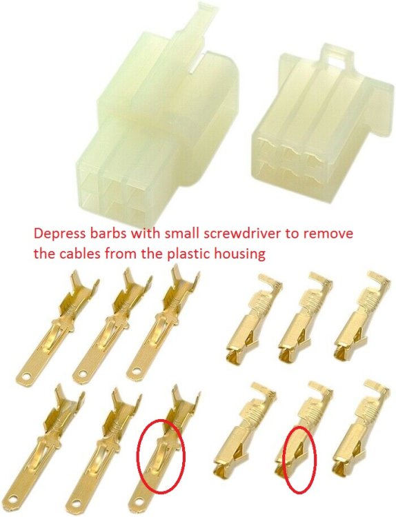

Hi, you can use a small screwdriver to remove the cables from the plastic block connectors.
On assembly the metal is pushed into the plastic housing and a "barb" keeps it in place.
To dismantle, push the cable into the connector to take pressure off the "barb", use a small screwdriver to depress the "barb", pull the wire to remove the wire (with metal attached) from the plastic housing.
Don't pull too hard. They're sometimes badly crimped, so the wire pulls out of the terminal.
