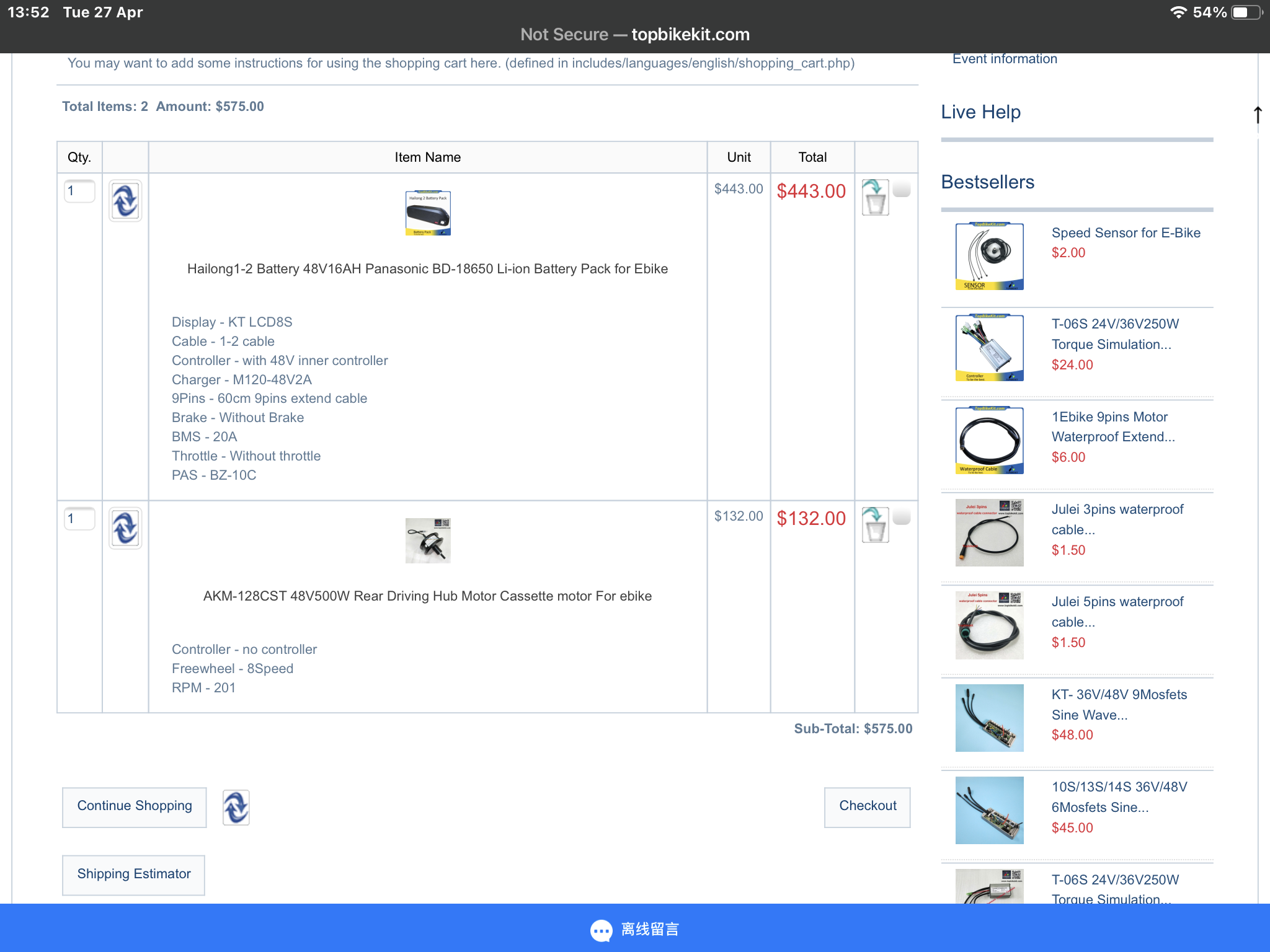

Would these go together?
Battery with built in controller and motor!
Is the price ok?
Is the price ok?
Yes.
You've selected the 1 to 2 cable. Personally, I'd go for the 1 to 4 with a throttle. A throttle is very useful, and contrary to what a lot of people think, it is completely legal if you set it to non-zero start in the LCD. If you ever have an emergency that prevents you from pedalling, it only takes a few seconds to set it to zero start in the LCD. With a motor like that, you'll be riding around on level 1 a lot. the throttle gives instant full-power when you need it without having to fiddle with lots of button pushes on the control panel. That can be very important when in traffic, especially at roundabouts. It's also useful for short steep hills.
Zero start means completely independent operation.
Non-zero start means that it only operates while you're pedalling.
