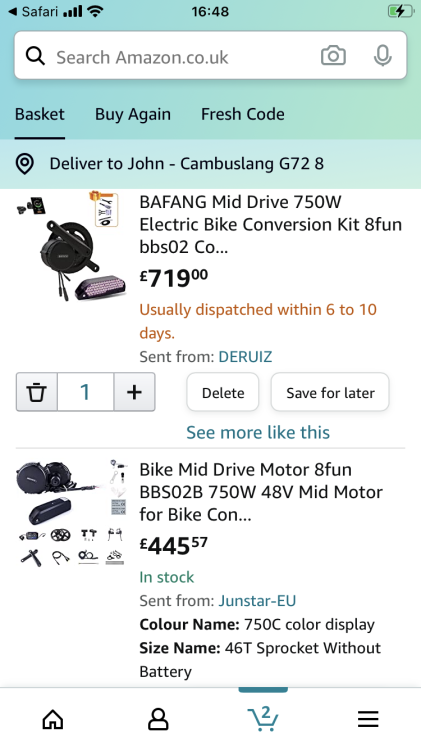

All good info Tony, the bottom bracket on my bike is 73mm so I was thinking of going for the bafang. John.
