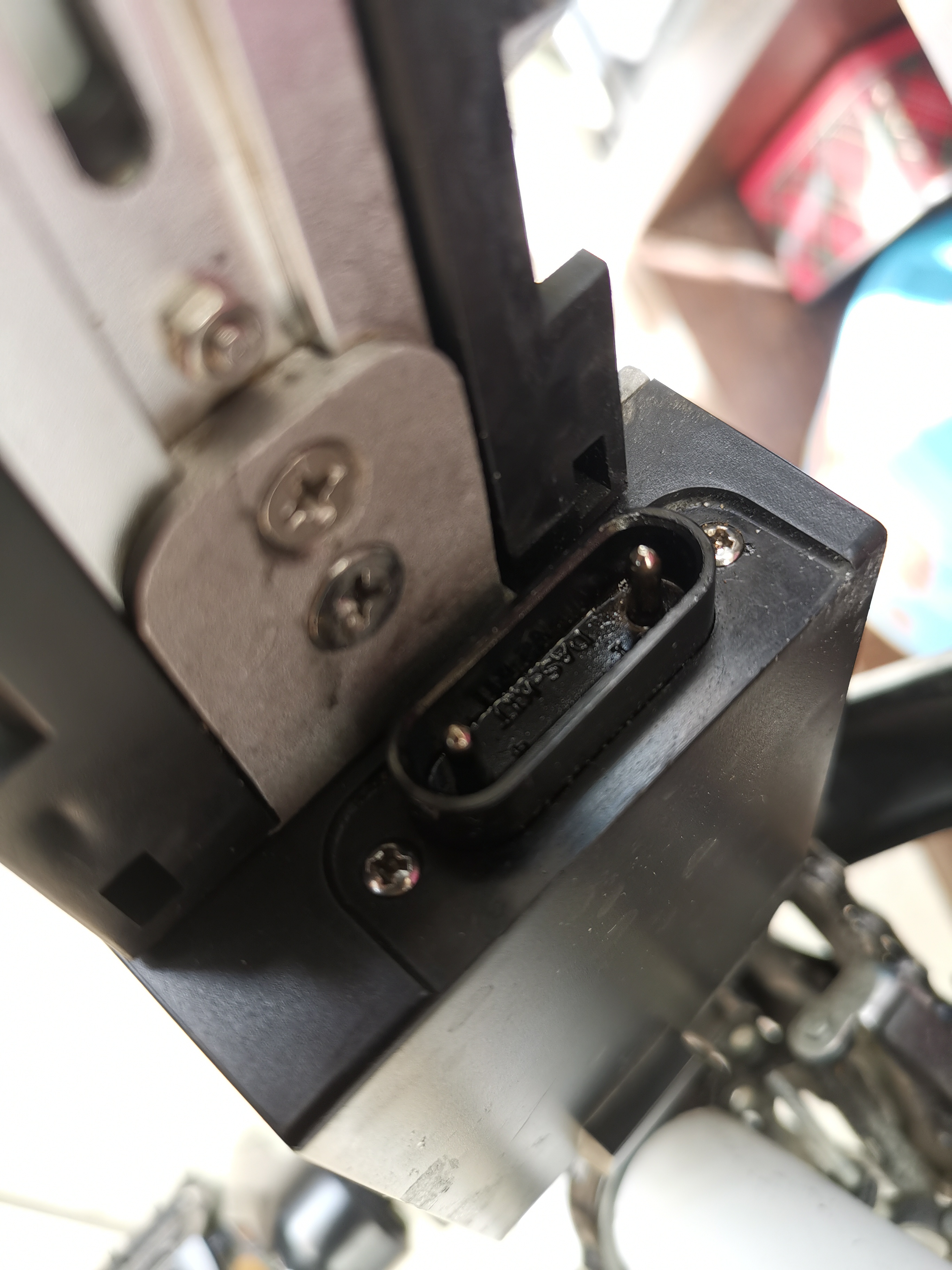

A "bodge" approach I was pondering was to add a rack battery, and somehow fashion a connector with the same discharge socket at my battery and run a cable from the rack to the mount ... Then when #1 runs out, I could just take it out and chuck it in the rack bag, plug #2 in and carry on. Only trouble is this isn't going to be the most waterproof or robust connection.
Plus I think it's a proprietary Das-Kit plug?

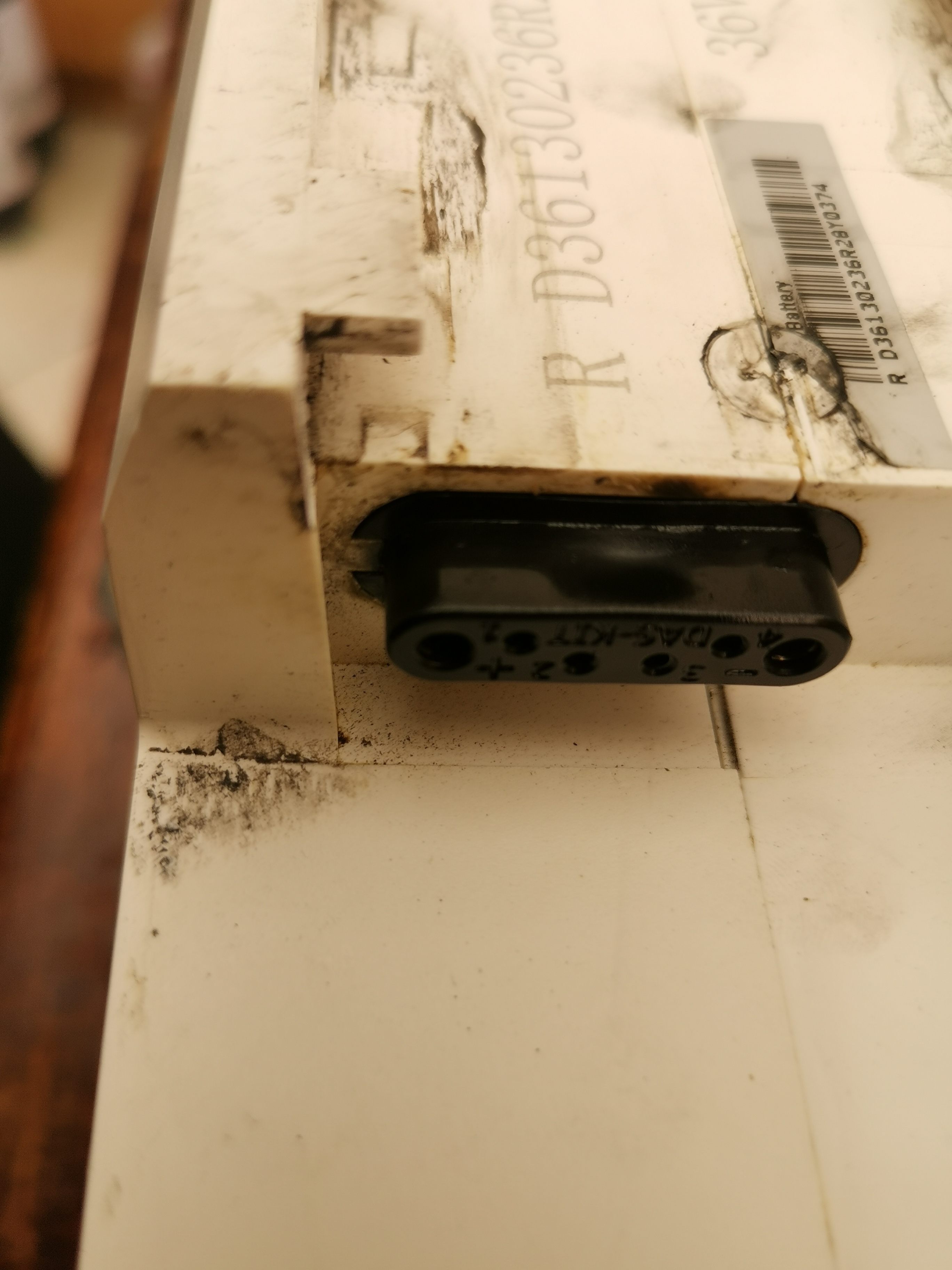

There was a problem on earlier versions of those bikes, where the connector terminals burned, which caused intermittent contact. One solution was to remove them and replace them with normal DC connectors, like Deans or XT50 on short flying leads. You could join the connectors then tuck the wire into the hole in the battery as you slid the battery onto the receiver.
The connector itself is now pretty standard, and it's used on a lot of batteries. I have one somewhere, but I'm not sure if it's male or female.

They fixed the cause of the burnt contacts. I don't know what they did but it seems to be OK now, and, as I said, many bikes use those terminals in their connectors, and they don't burn.

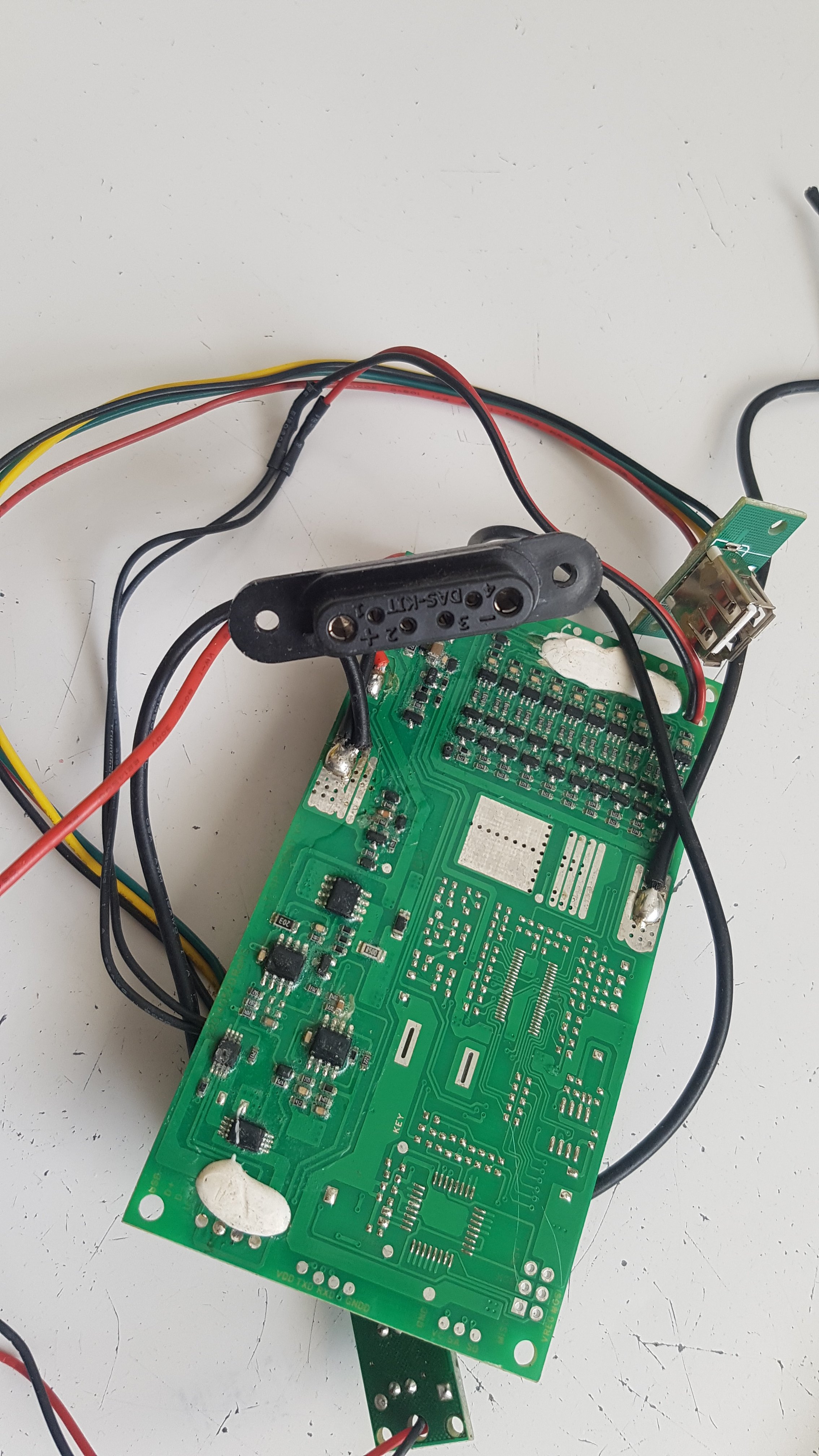

Here's what I have that you can have for the cost of postage if it's any good to you. I wouldn't guarantee the BMS because it was taken from a shagged battery (one cell group at zero volts), which could have had a number of causes.

Something like this was exactly my concern, which was why my bodge idea was that only one battery could be plugged in at any one time. The only concern is that the connector on the original battery is held in place by the battery being locked in place, so wouldn’t work very well with just a cable and plug.
[ATTACH type=full" alt="43468]43468[/ATTACH]
Thanks mate, much appreciated. I’ll be in contact if I go this route.
