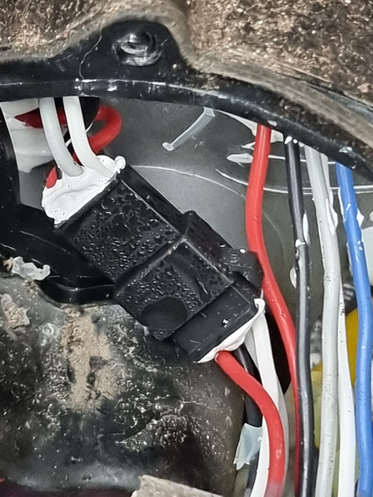

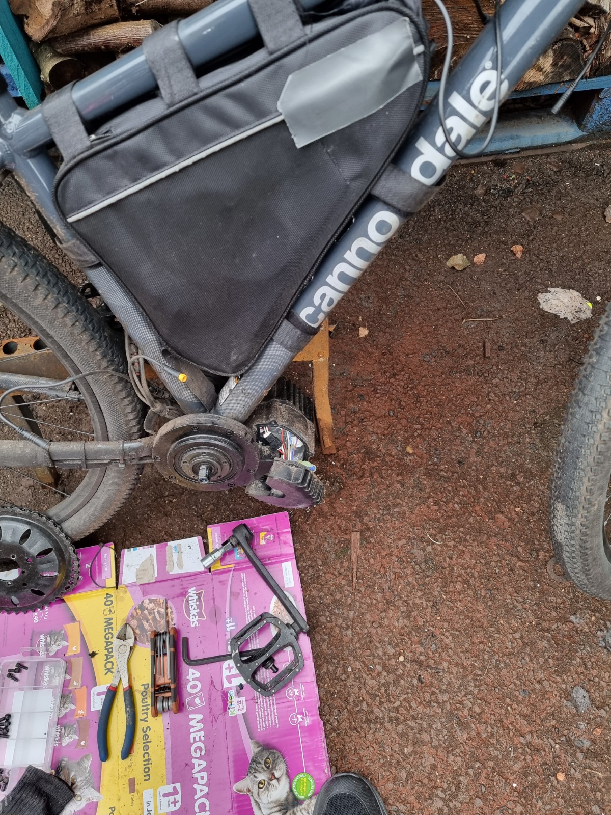

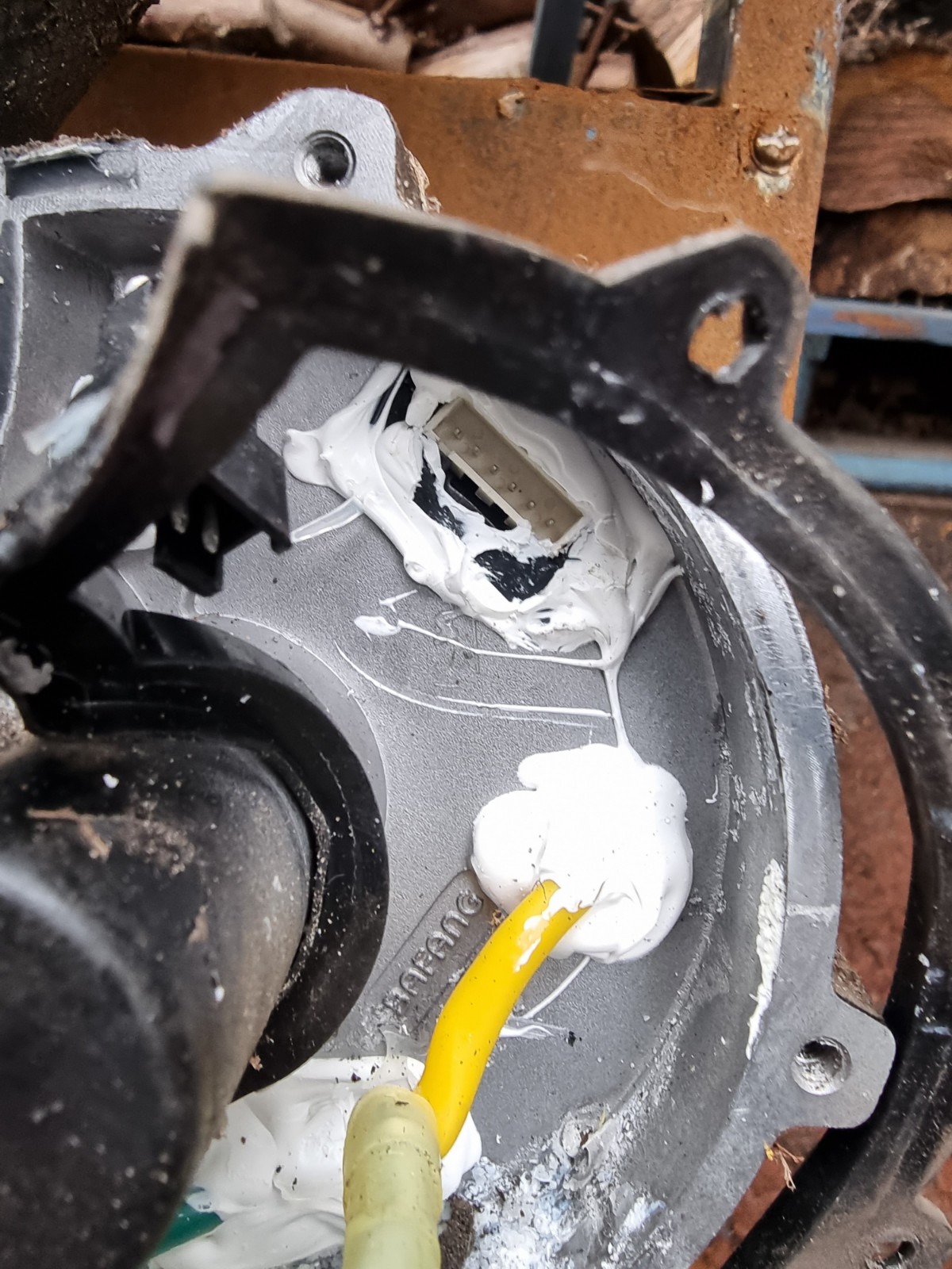

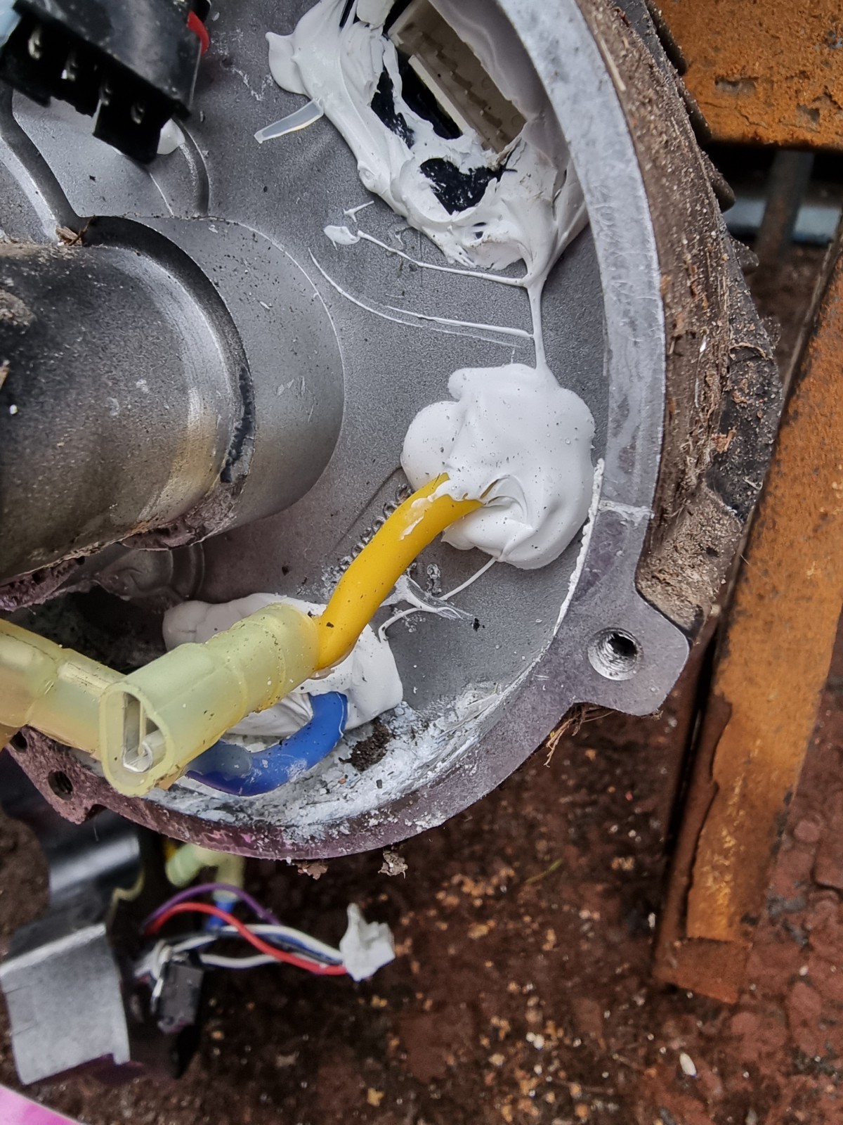

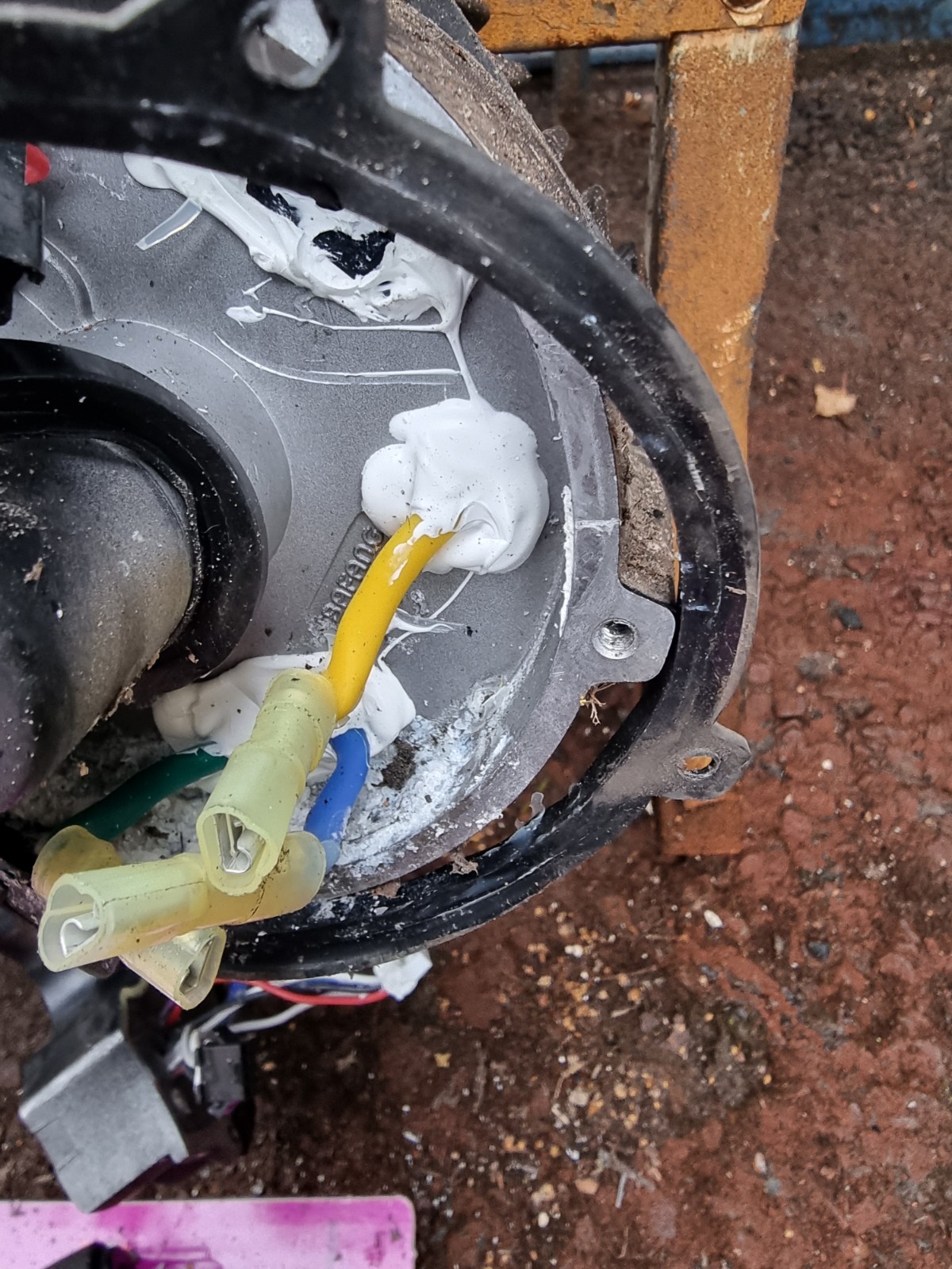

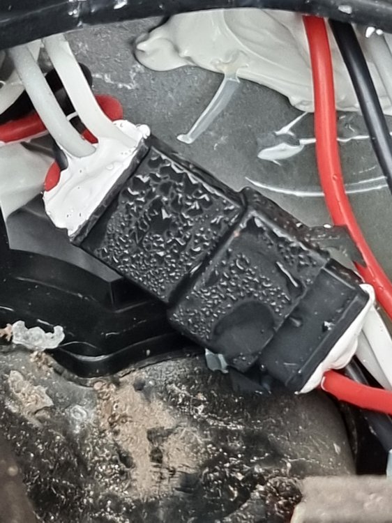

thanks all for the input, and it now appears to be fixed. i am one of those lucky few with a spare controller, so i swapped it and it's now done approx 30 miles over 6 or 7 journeys and hasn't missed a beat.
interestingly, i'm guessing something in the controller has maybe been on it's way out for a while, as for a long time now the PAS has changed itself sometimes, mostly (maybe entirely) when the throttle is used.
this became more frequent over time, and then other things like sometimes the PAS would stop working, throttle would work but no PAS etc.

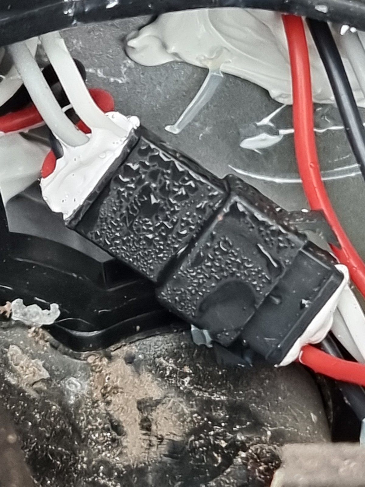

there was a fair bit of white gunk at bottom of controller casing (would guess maybe salt off the roads) and actual moisture on the black connector (silicon from factory at either end of it, so maybe this as opposed to controller itself?).
cleaned the white stuff out, and used silicon with the factory gasket , lots of youtube videos mention the factory gaskets are rubbish and water ingress often an issue.
