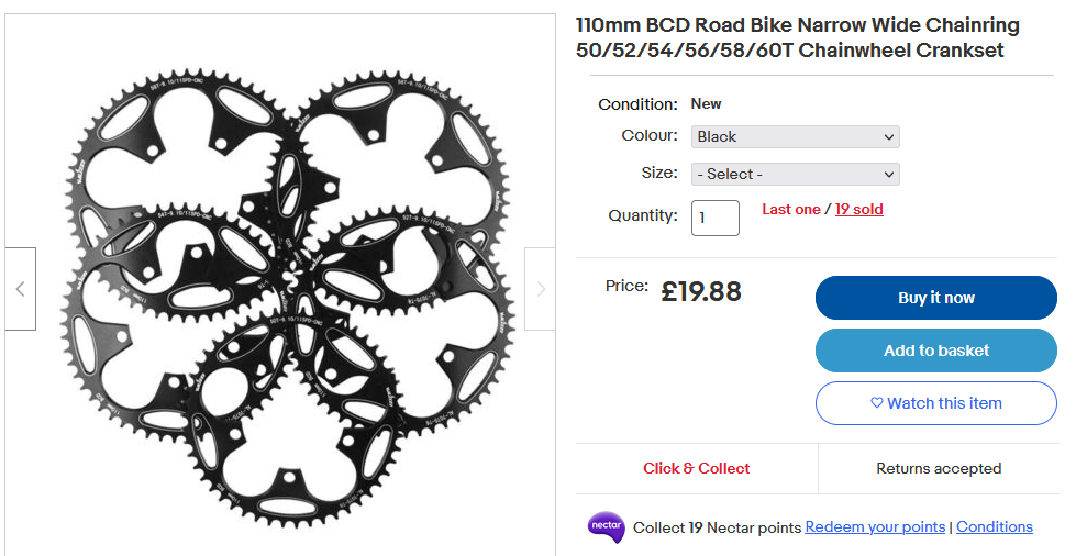

Getting big chain rings isn't too difficult these days:
