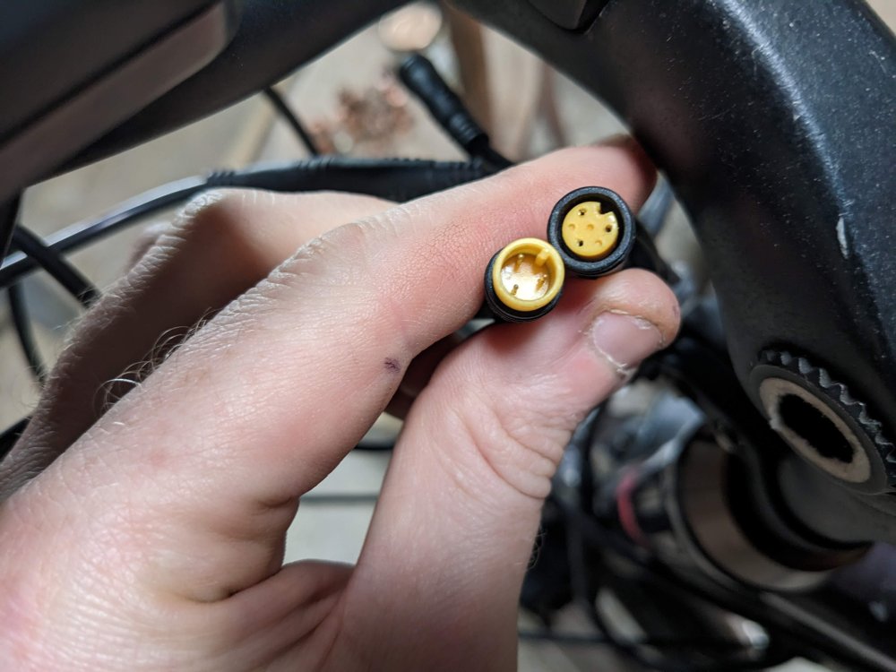

Maybe someone has been messing around with the wiring and connected the throttle connector to the brakes and brakes connector to the throttle.
Good thinking, but I have looked, and the throttle is a yellow connector and is in the right place.
So that maybe rules out the throttle as an issue. Also with the throttle unplugged the brakes still act like throttles - weird

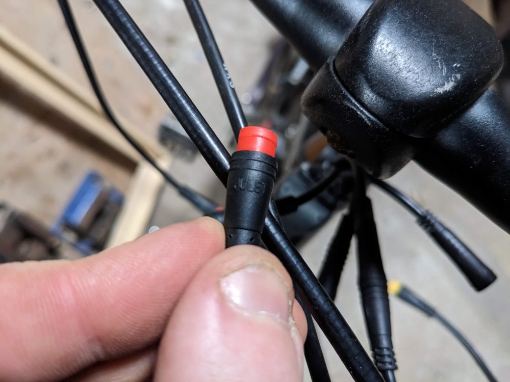

Are you able to post a photo of the controller and wiring, specifically the throttle and brake connectors?
yellow is the throttle wiring, red are the brake wires.
The controller is obviously degraded, but seems to work fine.

Crikey, that’s had a hard life. It looks like the cover for the rear brake switch is missing, does the switch operate properly?
Ah, that's just a sticker or something that has faded, the cover is intact and the switch operates properly.
