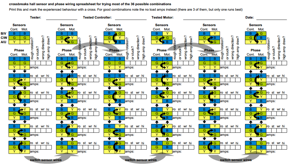

One can try swapping a pair of phase wires to see if C/W roataion returns, other wise one will have to go thru the 36 possible permutations if the motor is a sensored one.
Often three combos will work, just means a bit of time to see which is best.

P>S thanks for the diagram, I will use that in the future, very helpful.
