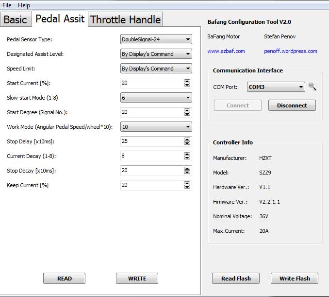

April 23, 20233 yr That initial jolt of power you get when engaging the throttle was new to me while feeling the torqueyness made me smile and had me thinking about conquering that hill i think its something i will look into trying to smooth out though. That initial jot made it difficult to make U-turns using my BBS01B conversion, but that and other niggles can be squashed: https://edrivenet.com/bafang-programming/ I almost demanded a refund... but after programming, my BBS01B is nigh on perfect (for me anyway). BTW, I'm curious to know how many times your friend has charged the battery over the past 3 years, and how often.
April 23, 20233 yr Author That initial jot made it difficult to make U-turns using my BBS01B conversion, but that and other niggles can be squashed: https://edrivenet.com/bafang-programming/ I almost demanded a refund... but after programming, my BBS01B is nigh on perfect (for me anyway). BTW, I'm curious to know how many times your friend has charged the battery over the past 3 years, and how often. I dont know but he did say in our time together that he was suprised he had no trouble with the battery as your meant to charge it regular. I was looking at the firmware thread on endless sphere earlier today, i need to get my 2 major niggles sorted first then get a little familiar with the bike then get my head around tweaking software to my liking.
April 23, 20233 yr The initial jolt on PAS can be lowered by changing "Start current" from 20% to 10%. Hills are a breeze with "Keep current" at 100%. Before changes: Edited April 24, 20233 yr by guerney
