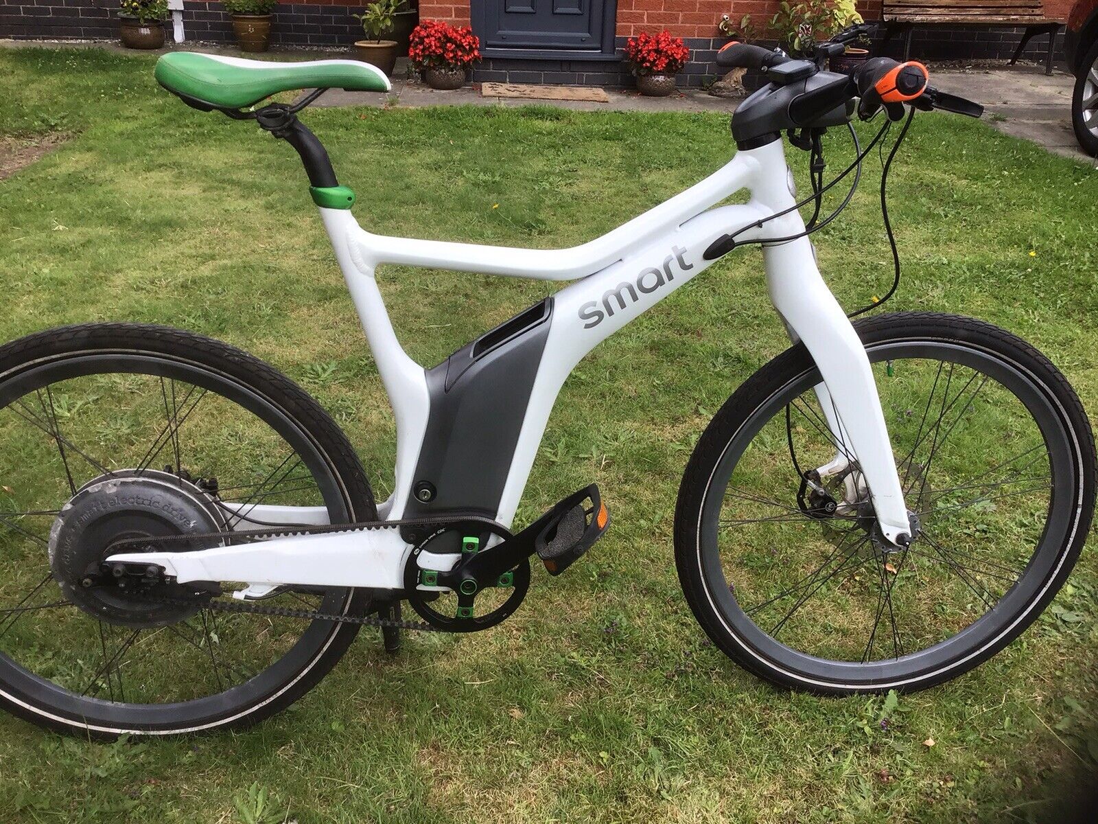

Does anyone know where to get a replacement battery for a Smart E-Bike, or maybe someone who could re-cell and fit a normal charging socket? Thanks
the batt has a coms channel to talk to the motor and display and it is also encrypted so a recell will be near impossible.

Ok. I'll give them a shout tomorrow? Could a normal battery, perhaps mounted on a rack, be used?
no the motor and display will have to be changed but if you use the batt case you can then recell it and use as a normal bike.

One option is to get the battery repaired with a normal cell-pack and BMS, then dismantle the motor and remove the controller, wire in a normal motor cable and run with an external controller. If it's like other Bionx motors, I'm pretty sure it splits down the middle, so needs to be de-spoked to get it apart. That's a lot of work, but means the battery will be repairable in the future. It also gives a lot more options for power and speed. It will be legal with whatever power you want as long as you keep the speed cut-off to 15.5 mph.
ill tell you now to recell that pack is going to cost £500+ so might be more cost effective to bin the lot and fit a new motor and display so bypass the controller.
RIGHT EVERYONE. THANK YOU ALL FOR THE INFORMATION. I WAS GOING TO BUY THIS WITH THE IDEA OF HAVING IT RECELLED TO GET IT OPERATIVE AGAIN. DOESN'T LOOK LIKE THIS CAN BE DONE EASILY? NOT ONLY IS THE BATTERY A BIT OF AN ISSUE THE REAR MOTOR ALSO AS INTEGRAL INBUILT GEARING SYSTEM. I'LL KEEP LOOKING FOR ANOTHER PROJECT. THANK YOU ALL FOR YOUR KIND HELP AND ADVICE.

Yes. I just wanted something a little bit more unusual. Don't mind working on them but there as to be a limit? For a project I thought I'd try to get a Smart frame and add some standard wheels and all the electrical gubbins?
The Smart frame is pretty bad. It's all too stiff and gives an exceptionally harsh ride.
