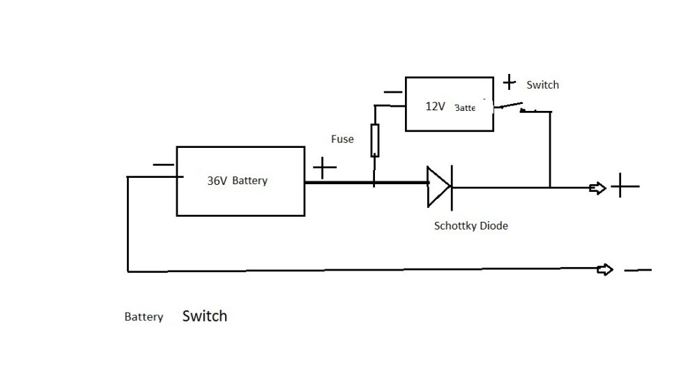

There is a simple if perhaps unrefined way to implement the uninterrupted switching in of extra cells as shown below that can cheaply be made. It does have the advantage that if the extra cells(or 12V battery) cuts out or is removed, the 36V still has a circuit to the motor. The disadvantage is the half volt loss in the diode, which incidentally needs to be mounted on heat sink and rated above 50 v and perhaps 30 or more amps for safety.
As regards the controller LVC, I think you may have to lock the controller to 36v with the 'L' setting. I am not sure how well that will work as the circuit below was only tested with a 36v KT controller and two extra cell. i.e 36 to 44V or 10s to 12s switch.
