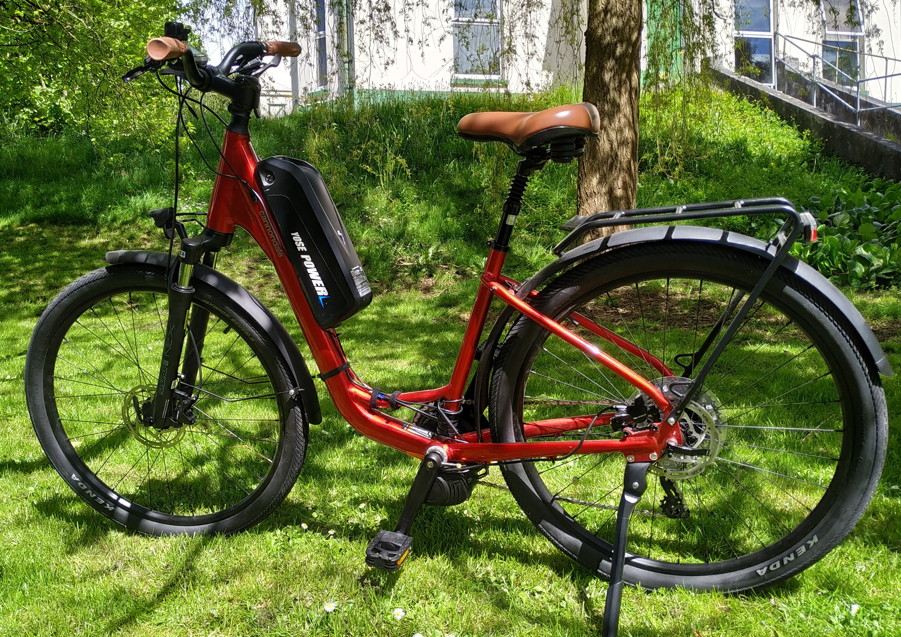

For rear hub conversion, the Shengyi DWG2NC motor has freehub, 135mm rear dropout. Same price as XF08C. The good thing about cassette is you have 11T on the smallest cog. That allows leisurely cadence up to 18mph with standard 44T chainring. Freewheels are not as good. Firstly, they wobble. Just spin the rear wheel and look at it. Not good for the chain and gear shifting. Secondly, you have 13T on the smallest cog, you have to pedal 17% faster compared to a cassette. 135mm rear dropout is pretty much standard nowadays. The DWG22C will drop in without effort.
Advantages and disadvantages. The disadvantages of freewheels that you mention don't actually give problems in use. Some look a bit wobbly, but they still give years of service. Freewheels give two main advantages: Firstly, the mechanism is inside the freewheel, which is easy and cheap to replace, unnlike some freehub motors that become scrap when the pawls wear. Secondly, freewheel motors always have wider stator than freehub ones, so they can handle more power. Also, the cost of replacement of a freewheel is a lot less, and freewheels generally last a lot longer than cassettes. Finally, freewheel motors are generally cheaper than freehub ones. For anyone that's pragmatic, freewheel is better than freehub for normal bike riding.
The vast majority (99%+) of customers never need to replace the freehub and I always keep spares.
Customers should go for the best available solution within their budget, otherwise you could save a few quid and never experience what a good bike can do for you.
The Shengyi DWG2NC and the MXUS XF08C are both available with freewheel motor lid. The difference in price is small.
I chose cassette body because of their superior features.
