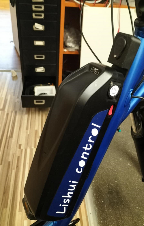

with this approach you´re not alone because there is a trend to see in this direction and thats why we made for our "Leadeer" set a extra small battery with integrated bluetooth display at the top of the battery and an integrated controller in the bottom of the battery to keep the bike very clean and stealth. This set works with cassette integrated torque-sensor, super easy to install even for somebody who never worked on bikes, just plug the batterycarrier to the wholes at the downtube and exchange your rear wheel, then connect the two cable, you are ready to ride. with performance that is not easy to find on famous branded bikes:cool: max output is when you pedal faster
On the other hand the most common wish among consumer though is a big battery and more power which is why I printed an extra slider for my yose battery that include an slider-extension for a one button-display (you can see it on top of the slider). Since I use those cassette integrated torquesensors I don´t need any display on my steering, just enjoy the ride. If you want play during the ride you could connect your phone to the display, check your riding data or switch between steps if necessary or simply follow the gps
