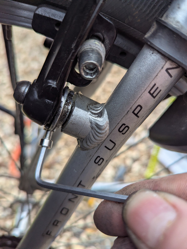

Post a pic of your callipers, when similarly frustrated i did just that and [mention=3847]saneagle[/mention] swooped in and pointed out the lil grub screw i needed to adjust ;)

I've also discovered that you can swap out the V-brake spring adjustment screws.
I have a cheap set on allen bolts and found one that fits. I always seem to mingle adjustment screw. This is so much better.
I think it's a M4 16mm long bolt..
