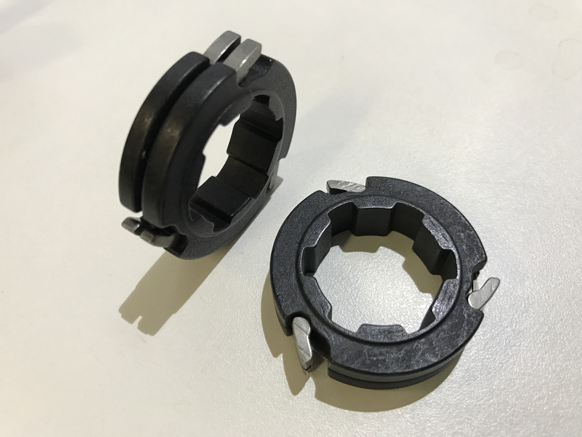

The freewheel has just let go on my bbs01b after approx 500miles, supplied new in Jan 17. Stripdown underway.

this is the freewheel (clutch) - it's difficult to get to, but not impossible.
As you can see, it's a robust mechanism but it can sometimes get jammed.
Not sure i'd describe this design as robust- there's not much of the pawl left after 500 miles. The female spline looks in good order though
The pawl at 2 o'clock looks damaged from your picture. Can you confirm?
Also, thanks for the info.
Wouldnt describe the condition as damaged - all three pawls are worn excessively, to a similar degree.
There were slivers of pawl material in the freewheel space, which must have been bouncing around in there, contributing to the accelerated wear.
I'm speculating any original surface hardening has worn away, leading to the softer sub-surface wearing super quick prior to failure.
I'm gonna try the dt-swiss versions - hopefully they'll last longer without damaging the female spline.
