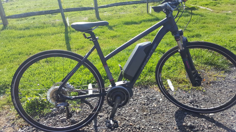

I test drove my new project. A £40 specialized hard rock sport and a 1000w cyclotricity.
24mph on the flat , me pedalling but with the very high gearing on the bike.
Haven't got the derestriction code yet . Is the code unique for each unit or is it simply a hidden menu.
I have also made a 5ah 48v battery which is doing the job nicely for £90.
Plan on upgrading the discs and making a second battery to leave at work and I can swap it out when I get there.
If this all pans out I'm going to put the same unit into my Cube hybrid .
I'm so impressed with the ease it all fitted.
Only problem was I needed a washer to space the forks away from the cassette and had to file a little off the upshifter onthetrigger shifter as it was fowlingon the throttle.
