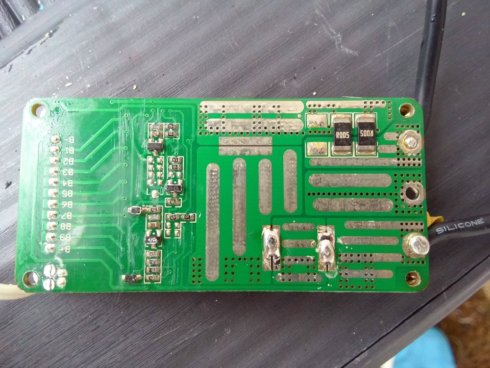

I’ve got the tool on order to open it up so I’ll know more once that arrives. It died for a minute, came back for a few mins, went again, came back then went for good. No weird noises, it was warm but not hot, and it was the warmest day of the year so far. Weirdest thing about it is with the motor plugged in, my battery bars are empty, unplug it and they instantly come back. Not sure what that means!
Hmmm, sounds like it could be shorted.
Someone on here might have a good idea what the normal resistance of the motor coils should be. It might be so low that a normal multimeter won't give a sensible reading. But you could look at the resistance of the different phases and see if there is any variation.
The above looks like mosfet short circuit in controller causing current to flow through motor winding when idle. Are you sure the controllers ok?

Yep, controller is working fine. I’ve got two controllers (one bought in error) and both do the same thing. Also the new motor is running fine when hooked up. Will say, the resistor nearest the power input on the controller is blackened, but everything is all working ok with the new motor.
