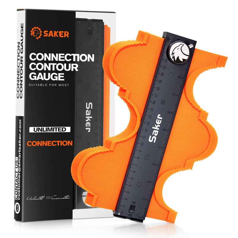

Does anyone know if electronic contour guages are available at a reasonable price? Could fit anything to anything with one of those, without the need for scanning. I suppose I could measure manual contour guages one rod at a time in a 2D grid, then build a wireframe in CAD.
