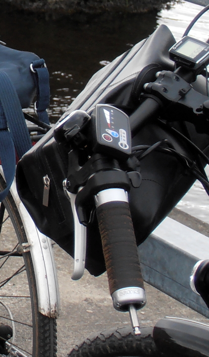

I have no experience of disc brakes with this kit, as I prefer the Magure rim hydraulics on my everyday bikes. Bionx has a brake cutout unit for hydraulic brakes that one can buy as a spare part. I don't use any because I don't use the pedelec fittings, only the thumb throttle, which has a spring return, and is mounted so that I must let it go before I can apply the front brake. The brake cutout is required only with the pedelec, which has no other control than the off-switch.
I tidied the controller box and extra wire length away into a repurposed leather wash bag on the front handlebar. The controller is tiny, so there's lots of space left for other stuff. It'll fit easily into a triangle bag.
Here's a photo of my pedal pal at the turning point of one of our rides to permit you to get your bearings; you can just see my bike's handlebar at the right side.
htttp://www.coolmainpress.com/public_html/miscimage/pedelec/kilmacsimonquay14july2012.jpg
Here's the wiring after it comes off the head tube and is angling across to disappear into the framed washbag on the handlebars ; the controller box is inside.
http://www.coolmainpress.com/miscimage/pedelec/tidying_up_the_pedelec_wires.jpg
Once you mount the controller up the front of the bike, and presuming you bought the bottle battery kit for the most beneficial weight distribution, it isn't too difficult to wire the lot neatly. I made the main trunk of the wiring up the fork, with the lamp wiring joining in at the crown, then up the head tube, then across to the bag with the controls' wiring running under the handlebars until it joins the main trunk and thence into the bag. Apologies for not having photos of all this but the bike is at the beach and I'm in town.
