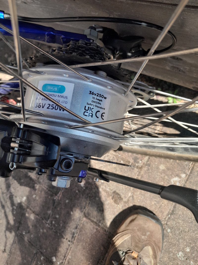

Any stipulation on sticker placement?? hmm time for malicious compliance perhaps??
Version #1 complete with the text
"FP FAB EN:15194 36v 250w 15.5mph"
Printed vertically on 12mm brother label printer tape is circa 15 cm long..
btw FP FAB- Fat Phil Fabrications.. Both Ortler and Yose-power etchings decals and stickers are already clearly visible on my Hub and bike.
will need to charge the camera batteries for pics..
Though i think i may splurge £6.99 on the clear tape for the final label. currently i have a blue on white 12mm tape loaded.. I have 6mm clear tape but that would be taking the **** ;)
any mention of lettering size required?? 6mm tape is starting to sound optimal ;)

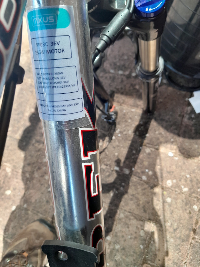

The law doesn't say anything about where the label comes from, so there would be no such thing as a fake sticker; however, if you misrepresent the bike by putting false information on the sticker, like 15 mph, when it can actually do 20 mph asisted, that's fraud.
You don't need anything fancy on the label - something like " Motor Aikema AKM95 48v rated power 250w; Battery Greenlance 48v; Controller Kunteng 48v; Max assist speed 25km/hr" stuck on the headstock meets the legal requirements. The only problem is whether the police believe that information, so you need something on the motor to indicate that it's the same as what's written on the label. That's where a convincing "fake" label has an advantage, when the motor doesn't have its own identification marks, but on that label, you don't need the 15 mph and other stuff - just the manufacturer and the 250w.
OK, so these are the stickers I've settled on. I will be printing them on glossy photo paper and fixing them with helicopter tape.
This is for the frame:
This is for the motor:
What do you think?
What do you think?
That looks pretty good concerning the info, but for the motor one, I'd move the logo down a bit and the 36v 250w up to make it narrower and more like a label for the motor. Trim off the surplus.
Will do, thanks.

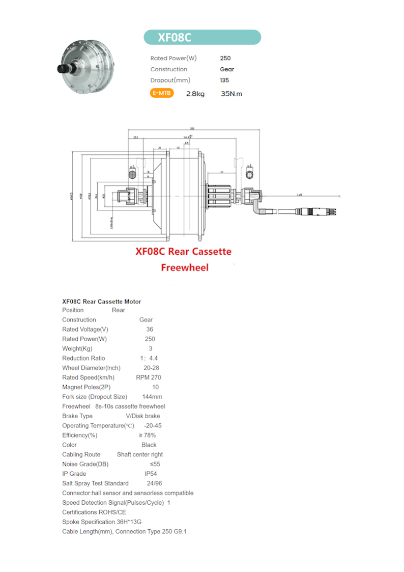

I also carry a spec sheet of the motor and the invoice from the conversion kit seller (without the red bits of course)
