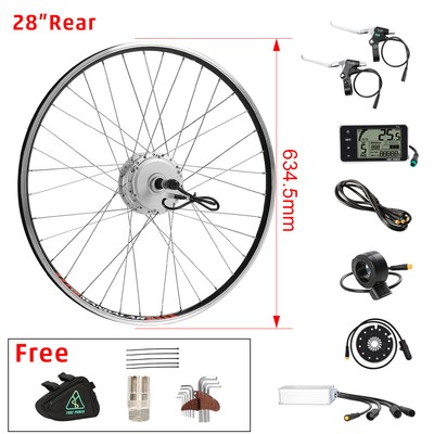

I have bought a Dutch Batavus Lento and plan to convert it to an evoke. I have spent probably too much time researching and come up with more questions than answers. I have looked at two companies who offer the full kit and apparently easy to fit. One is Cyclotricity is and the other is Powerbikes. Has anyone used these companies before and are they any good. I think I should be going for a front wheel drive. Looking at spending around £500 for kit and battery. Any advice gratefully received. Thanks

Show us a picture of your bike. There are different versions. The latest ones would be tricky to convert.
vfr400
Jun 12, 2011
9,822
3,994
Basildon
OK, that one's not so bad. There are a load of kits that will work. whichever you choose, make sure it comes with an LCD control panel that gives 5 levels of assist. Also, a throttle is very useful.
The ones I'd recommend are the Yose Power kits, which you can get from Ebay or direct from their website, or from Woosh if you want UK support.
The Yose kit says 350w, but it's the same motor that others sell as 250w. It's unmarked, so nobody would know either way.
