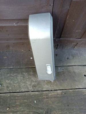

So I phoned Halfords this morning told them the situation and they asked me to bring in the battery and they’ll take a look and replace it if necessary. Let’s see what they say.
in the meantime I’ll continue to research batteries.
rajeshtailor
Jun 5, 2020
170
3
So Halfords phoned and said the battery looks like it has been opened so the warranty is now void they can’t do anything.

did you check the cell bank voltages from the sense cable ? as if every bank of cells shows 0v id not reuse that bms as it should not do that and should have a sleep mode to protect the cells.
