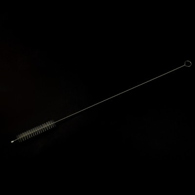

The neoprene discs arrived today. At 0.5mm thin, they look like they'll fit well, do the job. I wonder if the CF version is compressible neoprene sponge? I'm not paying their mad delivery prices to find out!
The "Extra long" thin bottle washer arrived too, will give the trailer axle innards a good old scrubbing with oil later. First with WD40, then maybe Hypoid 90. I'll extend the brush with a coathanger.

The axle bore is only approx 65 -70mm in length.

I'm going to clean out all the muck - thanks to the absence of those neoprene washers, I think it's got very gungy in there. Then I'll dry it out by interting a funnel on one end of the trailer axle, and pointing a desk fan at that for a few hours... then slick it with oils.
By the way, those brushes are three for £2.99 at Aldi atm, sold as "Stainles steel straw washing brushes".
