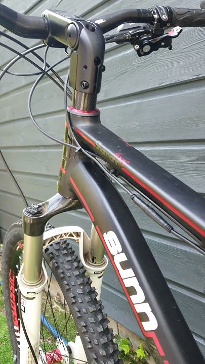

Weight in the middle.changes parking and maneuvering so so much
My rule of thumb is I should be able to lift up my unpowered bike with one hand. I will then know for sure that I can load the bike in the back of my car on my own if I have to.
All factory made bikes are compromises, including the Crusa that you bought from me, especially on weight. I would therefore find a push bike that has as much quality that suits my need then fit the lightest kit to it.
A simple and cheap option is the 9.4kg Islabikes Jimi.
I have a similar Schwinn step through in Southend.
I reckon the 85TS kit from Tonghang would be a good candidate for your need.
Only 3 components to install: the motorwheel, the battery and the LCD. The motorwheel in this kit is state of the art as far as conversion kits go. Inside the cassette freehub body, the maker has integrated a torque sensor, a pedal assist sensor and a speedometer. This high degree of integration is the key to deploy this kit on high end bikes, even those with carbon frames and pressfit bottom brackets.
