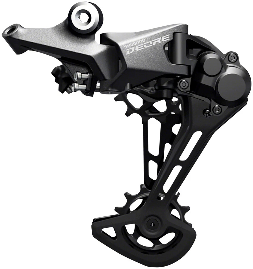

The spec says you have an M5100 derailleur
Has that become very slightly twisted and bent by being dropped? Too many holes for my liking, looks flimsy but might not be.
Or has the derailleur and/or hanger been further bent by mad high Bosch motor torque, after either or both were twisted a little initially by the drop? Has the new hanger been twisted because of the already slightly twisted derailleur being subjected to high torque by the motor while at the wrong angle?
If the end stop for highest gear (smallest cog) is slightly off, might one inner side of the chain be rubbing against it, hopping up slightly when motor power/high friction is applied, instead of sitting central?
