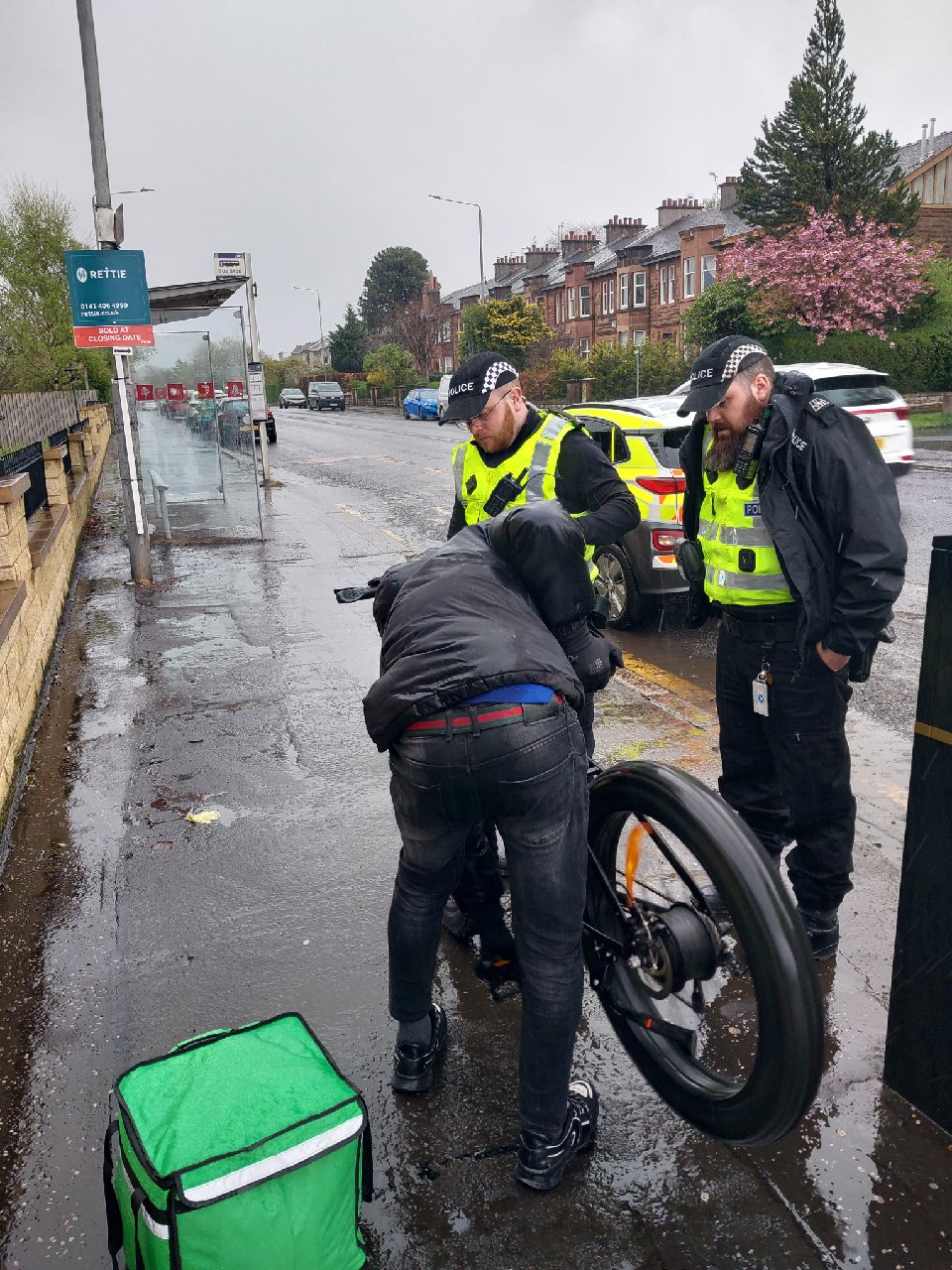

You can see the bike being tested with the wheel off the ground:
9,452
4,209
He seems to have a hand on the pedal, so that bike must be pedal assist only, and he's trying to get the motor spinning by turning the pedals. I can now see the advantage of those rubbish controllers that gave you speed proportional to how fast you pedal. I think I still have some somewhere.

Why is delivery guy testing his motor speed while plod stand by?? Ive been pulled over a few times over the years for a random safety check lights tyres indicators etc, Not once has plod let me officiate the testing??
12,231
3,410
Do the cranks rotate a little when throttling? Perhaps the delivery dude is holding the bike steady while the cop is testing throttle top speed? Looks a heavy bike.
