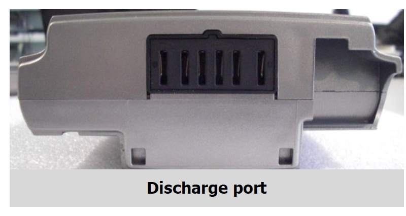

I have had no issue fitting the sm01 as in the link below to my Boardman, I simply used the existing rivnuts wihtput issue, before that I used the DAS kit type dolphin batteries. Never used extra securing or strapping and have managed quite nicely on offroad routes and riding the nooks and crannies on the South Downs going truely off the beaten track where most riders don't go.
No Tax 36V 14.5AH Haitian Electric Bike Battery Pack Bicycle Lithium 18A BMS output 500W fits bafang tongsheng TSDZ2 (pswpower.com)
