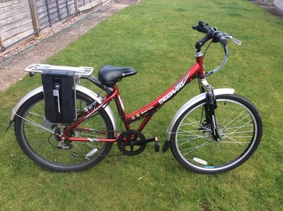

On that point, is there a solid reason the batteries can't actually beneficially be mounted as panniers, side mounted lowering the CoG that I believe is why technically the rack top mounting is not liked?
I think that depends on how the rider mounts the bike.
On a Dutch frame bike, the rear rack battery causes no problem at all because you don't have to swing your leg over the luggage rack.
If the battery is mounted on the side of the rack instead, the centre of gravity is shifted onto the side where the battery is mounted, so you gain a little on lowering the centre of gravity but losing on the equilibrium when pushing the bike.
I had not thought of doing it asymmetrically, but equally on both sides, and had said "batteries".
Whilst some might struggle, possibly me now at my age, I have cycled a fair few miles on a crossbar bike with panniers.
Just thought mounting the batteries in that fashion, addresses some part of the high CoG issue, I know others find off putting, and curious why a seemingly obvious approach has not, to my knowledge been adopted.

The Santana though, has the pannier rack battery that was expressly stated was not preferred.
They could just be a cell thick, so not be too intrusive and double as side fenders.
This has been discussed a couple of times before. Below is the first bike I've seen set up like that.
