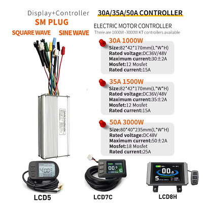

Only just got back to this - had to clad our new oak framed garage, supervise the slate roof and all manner of other things. Played around in our paddock today, and I now totally understand what you've all been saying about speed based rather than power based. It doesn't really feel like pedal assist, it feels like pedal a revolution or something, motor tries to achieve a fixed speed, stop pedalling and after a (too long for my liking) delay, motor cuts out. All the ebikes I've ridden before feel more like I have bionic legs, which is what I'm after. So I guess I'm going to throw some more cash at the problem and buy a KT controller and compatible display.
Found this on eBay, any thoughts?
9,509
4,242
Can you remind us which battery and motor you have? Are you currently running with 36v or still on 24v?
9,509
4,242
Giant sync drive front hub motor, 36v 10.5ah battery from Yosepower..
OK, 15A is about as high as you can safely go, so get the PSWPower one. It would be best to get the type with block connectors, not the moulded waterproof ones because you might need to re-arrange the motor connections, which is impossible with the moulded type.

Thanks. I'm having a lot of trouble with that website, it's hard to tell what I'm actually selecting. Reminds me of AliExpress, where you think you've ordered a pair of shoes, but it turns out you've only bought the laces...

Yes it's weird, they really should fix that website. If you are having difficulty adding stuff to your shopping cart: deselect everything, select UK delivery, then select your kit options, and "China" for "Ships from".

They show 3 pictures of controllers, but no description of which one they are... Do you suppose the LCD comes with a cable? And what is the optional cable I can order? Very confusing, but good cheap price! Any help gratefully received!
9,509
4,242
Select the first option, which says 24v/36v 15A, then select all the other stuff to go with it.

If the above doesn't work, you can always get one from Topbikekit. Add the LCD, throttle 8PAS and a speed sensor if you don't already have one.
This is how it looks on PC, I don't know how t looks on Android, iDevice etc... they've got controller descriptions in the "Alt" tag of the images, which only appear when you hover over them with your mouse pointer, and what you've selected for "SKU" only appears above after you've selected an image.

This is what I ended up ordering, after moving to a desktop and much agro.
KT kunteng Electric Bicycle Motor ebike Controller 24V 36V 48V 250W 500W 1000W Brushless DC Sine Wave sensor Controller
My hub motor has totally different connectors for phases and hall sensors, so I guess I'll need to do more cutting and soldering, unless there's some sort of nifty breakout cable available...
Thanks for all the help/advice, and hope I haven't bought the wrong kit!
