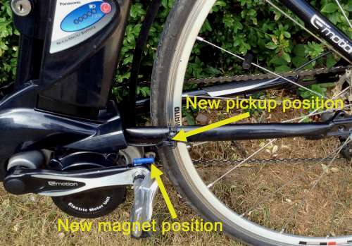

That's correct, in fact they produced two 36 volt units, the second more compact. You probably remember the 36 volt version had a dongle available from Martin at e-bikeshop.
Here's a photo of part of a BH emotion 36 volt Panasonic unit bike using the speed sensing magnet alternative dodge for higher speeds.
