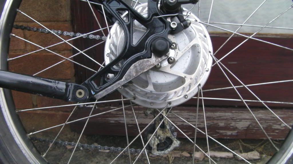

The rear dropouts on my Giant sus bike were quite tricky to fit ready-made torque arms, so I made a left/right pair from 3.7mm thick stainless steel plate.
I made cardboard templates first, with large wrap over tabs to fit snugly around the frame dropout shape. I calculated that the maximum "moment of torque" didn't need the support to be very far from the radius of the axle. The advantage being that they're quite small, so of no significant weight, despite being steel.
I cut the 14 mm axle slots very carefully, finishing off with a file to make sure it was a perfect fit. I think that the combination of both sides gives a combined thickness of 7.4 mm, which should be ample, especially in steel.
The result is quite unobtrusive and blends in well.
