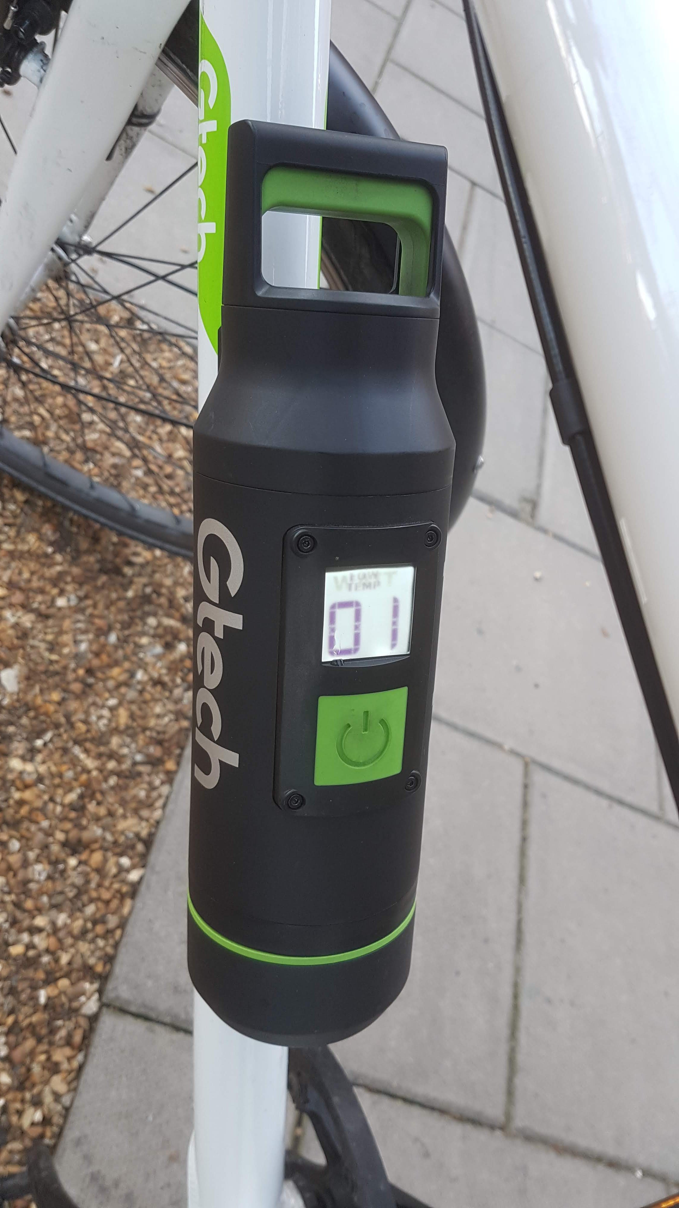

  7. Bad news, this morning, just after 370 miles, my gtech decided to die half way through my commute. It just stopped, with this warning: 01 - WAIT Low Temperature. It was a sunny, but chilly ( -1 C ) day I used it when it was -5 and it was fine before. Anyone had this?
