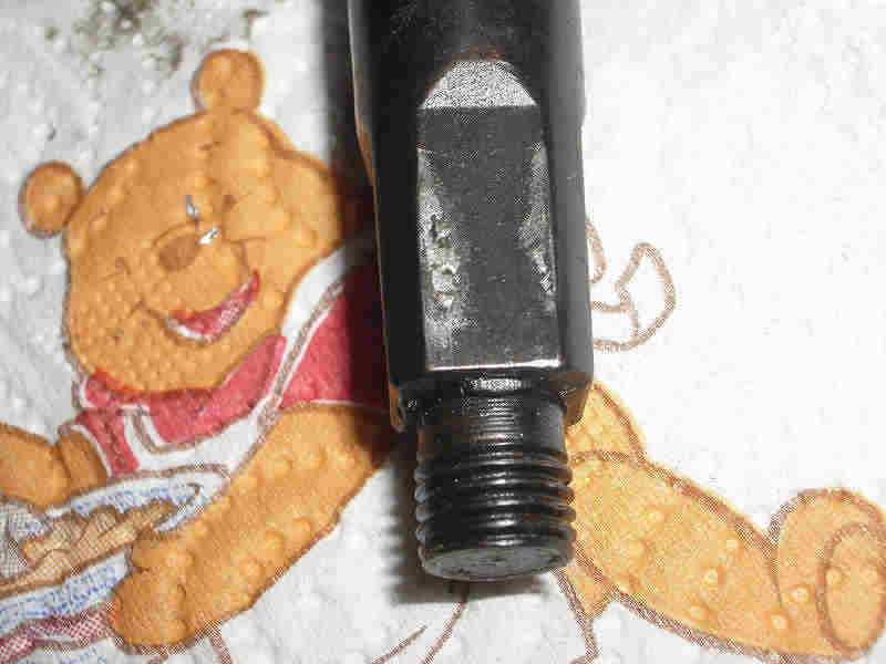

  9. Hi, I had exactly the same problem, Norman talked me through sorting it out, I just dissasembled it cleaned the bearings, greased them put it all back and tightened up and the problem was sorted. Heres a few pics.. I'm sure Norman will talk you through it, but if you need any help give me a shout. Paul
