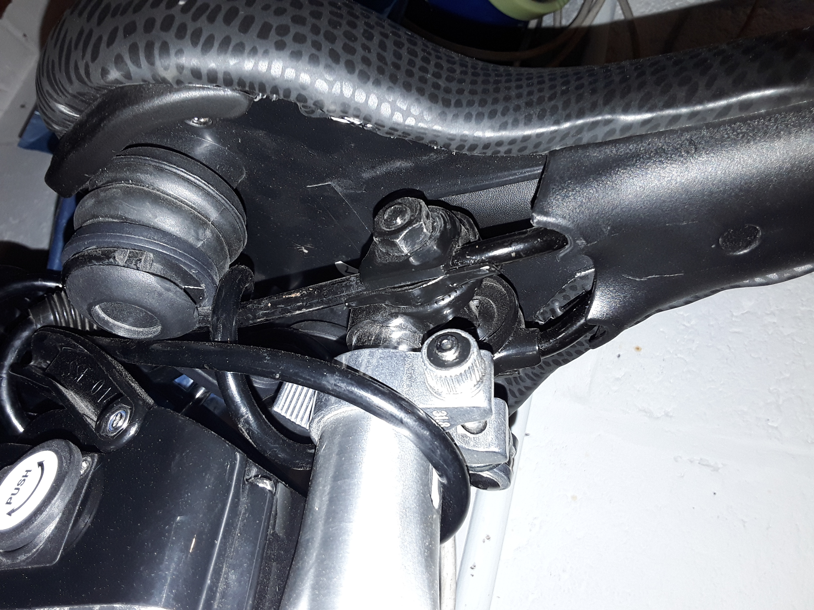

  5. I removed the suspension seat post and put a standard one on, als make sure the bolt holding the seat goes above the clamps, see photo. That gave me almost an inch. Bob
