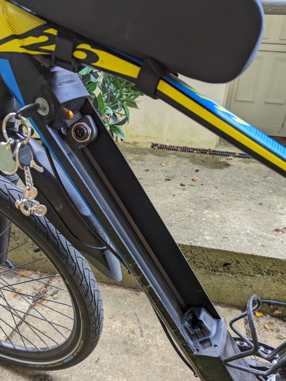

  1. Sorry didn't think. I blame it on old age!!. My bike is a Woosh Rio MTB. I have uploaded a photo of the frame which hopefully may help
