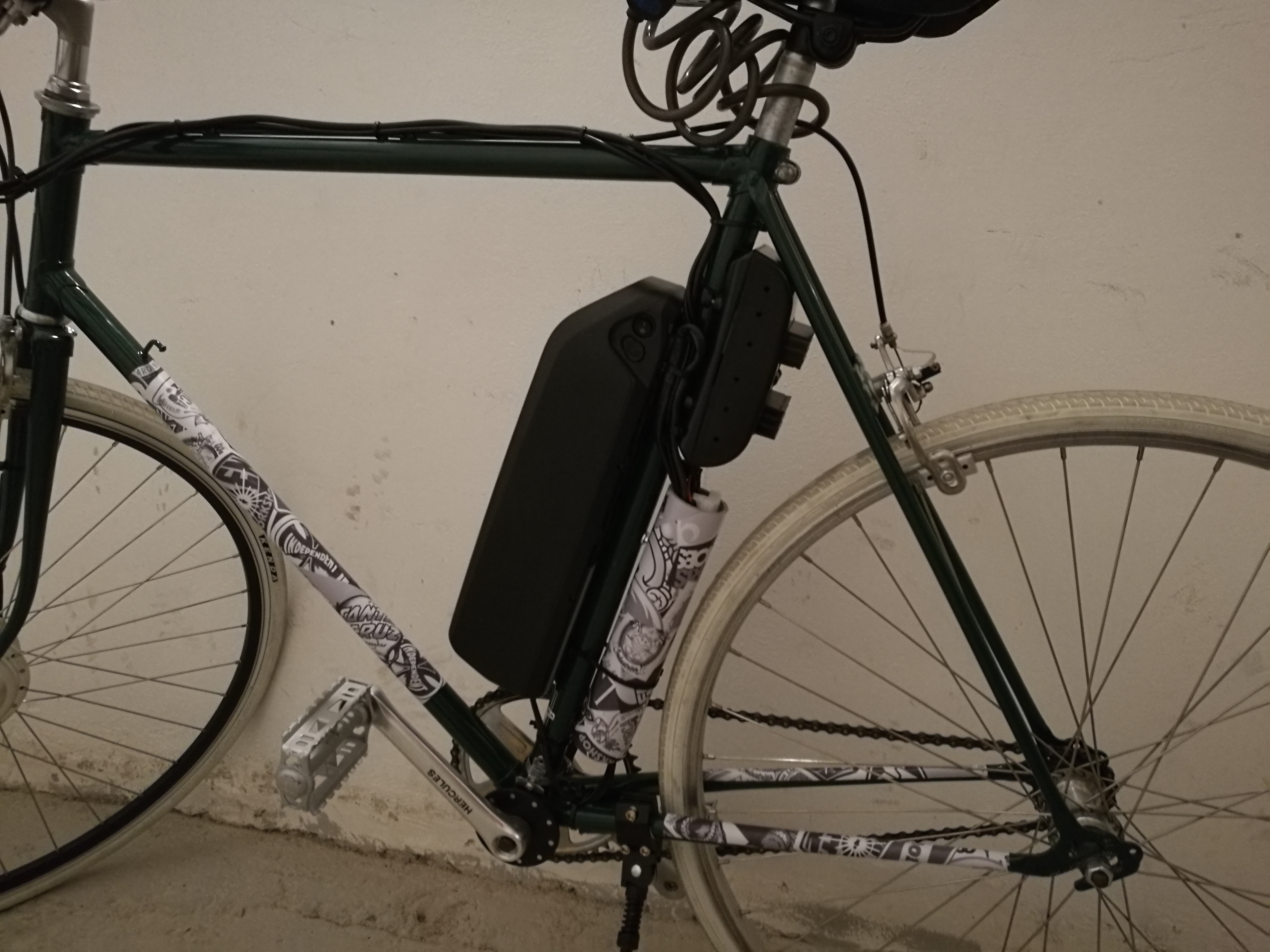

  11. This is what i did for the excess cables A small pvc pipe wraped with a sticker i used on the frame.

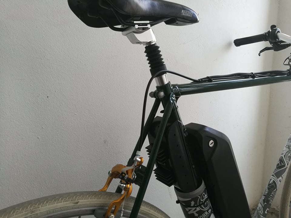

  12. I just made two small upgrades. I used a small pvc pipe wrapped in sticker to hide the excess cables and also fitted a heatsink on the esc. I had to cut the enclosure though. Now i'm waiting for the new handlebar, brakes and levers...

  14. Ok, my Thermal Grease Paste arrived and in the next few days i will add the heatsink to the esc. I found out, that you can add heatsink to the motor as well, it's called hubsink. Anyone tried that? I would like to add something like that, because i'm worried about the motor heating up. We have very hot summer days here in Greece. Am i overreacting?
