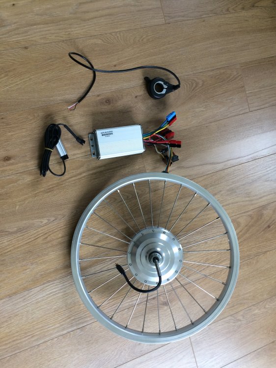

  1. Here are the pics, as stated currently lace into a 20" rim. I have the controller that can be re-programmed which I could do for you or provide a programming lead for you to play around with it yourself. Probably best continue via PM if you are interested.
  2. I/you could do that I even have a very lightly used black 36 hole one (I will post a picture) which I haven't listed. I have tried it in a 700c wheel but given these are 260RPM I had to programme the controller to slow the RPM right down/keep the current within spec. It then worked perfectly in the 700c rim but I only used it for a few weeks to test as I was going to do it for my daughters new bike. I had relaced it into a 20" wheel as you will see it in the pic but its remained unused. I should still have the spokes for a 700c wheel but would need to buy a new rim. Jerry

  9. Hi, Now I am getting back into doing conversions I have quite a few spares that need to be cleared from my stock. If I cant sell this stuff here I will put it on ebay without the offers to help with conversions and lace up wheels. Hopefully give something back to the forum if Brompoton owners are looking for a little help adding a kit to their bike. Of course you could wait for the new Brompton solution 1. First up I have all the parts new to convert your Brompton using the popular Tongxin narrow width motor. £200 + p&p. You will need to source a battery or see 4/5. below. Includes built up new Tongxin motor in new 16" Brompton rim, controller, throttle and hidden cutout brake sensor. Closeup of the 36v, 260RPM, 83mm wide, 28h motor which will give you around 15mph assistance. 2. I do have a few unlaced narrow width Tongxin motors, (will convert most 16"-20" bikes with front hub conversion), and controllers. Looking for about £110 plus p&p for brand new motor. Could probably throw in a free "used" specific controller/throttle/cutout as well. You will need to build wheel/connect up controller, battery etc ( unless you want me to help see 4/5 below). 3. KeyDe kit. Full kit small 1.6Kg 36v, 28h, 260RPM front motor (new unused) with "used" controller for pedelec only function, new unused PAS and cutout brake. £150 + p&p. This will take a 16-20" wheel up to 17mph. You could also use a fully programable controller (I have one for £45) for throttle only if you want. I will lace it up for you as per 5 below. 4. I have some older small battery packs A123, 10s1p, 36v, 2.4Ah batteries and chargers which you can have free with any of the above. These are used but still have life in them and probably good if you need to test/do small journeys. I cannot post these, so collection only. 5. If you live near me (Cambridge) now that I am retired, I am happy to maybe help you with your conversion. All the motors are for 16-20" wheels and again happy to build them onto either for about £40 including rim and spokes. Postage would be more than a bare motor obviously. Here are some of my conversions for which there are complete build threads on this forum. I have a spare Brompton umbilical/wiring loom again which I can use to help you if you want my offer of help convert your Brompton. email or pm me if you are interested. I will not post outside the UK as had my fingers burnt with this before Jerry
