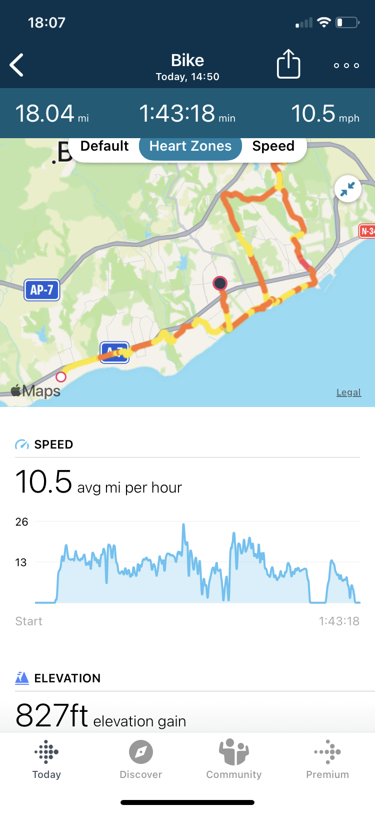

  5. Not a bad location to add another milestone. Also liking the new features (to me) on the Fitbit app.

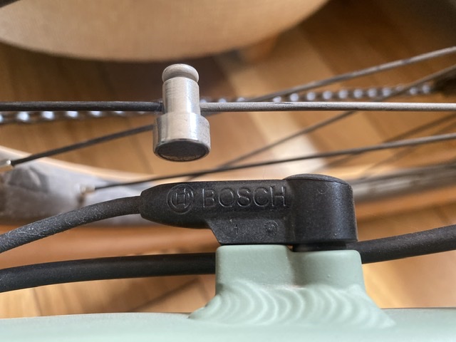

  21. So I’ve just taken a picture and it appears I’ve moved it to its correct position, mine was originally positioned to the right above the S. The speed reading has been out since i first checked against gps. I’ve read elsewhere it’s common as to compensate for different tyres and air pressures , but over 10% seems too much and surely if they fit “smart sam” to this model then calibrate accordingly. I have increased tyres to 2.6 bar from 2.4 but it made no difference. I was going to ask at service time for them to recalibrate as it will be reading approx 1000miles for every 850 ridden. I’m doubting the reasons given about tyres. On the fall it was mainly cosmetics to the derailleur, it was out of line when I started again so I‘ve gently pulled at the derailleur and hanger to line it up. I’ll get it all checked out when any of my local cube service shops reopen for servicing.

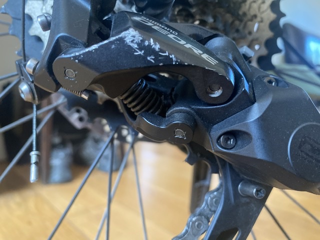

  22. After a fall the other day and landing partly on the derailleur I have straightened the hanger and my gears now move much more smoothly , so the chunkiness on shifts must have been due to the hanger alignment! With tools to hand I also moved the spoke pin about 5mm further outwards and my assistance cut off point is now 17mph on the purion display , 15.5mph on my runkeeper gps. Did 18 miles this evening averaging 13.45mph in gale force winds , very happy at the end of the ride to still see 5 bars showing and a tour range left of 50 miles.
  23. I’ve noticed a perceived drag above an indicated 16 but thats just the assistance cutting out, a few seconds later its all forgotten. Never noticed on a downhill and I’ve hit some silly speeds....30 plus while braking. When I’m above 16 and prolonged I click down to off mode , the motor disengages and more natural pedalling. I did start out chunking the gears quite often , I‘ve learnt to pause for a spilt second to let it engage properly and then continue, can certainly feel the assistance kick back in. It definitely smooths out the changes and becomes second nature soon enough.
