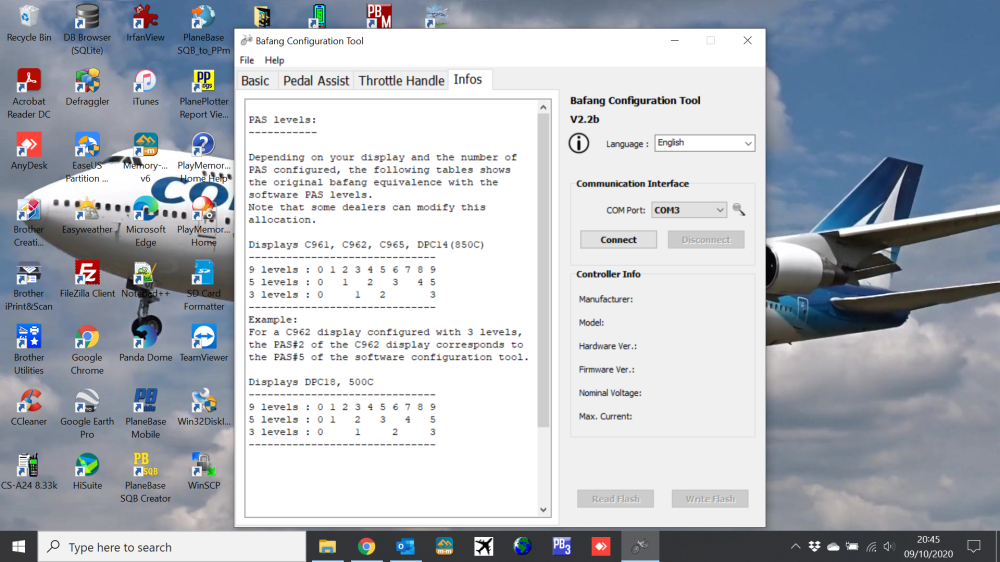

  2. And from the Bafang Configuration Tool, v2.2b - which seems (to me) to be correct.

  4. Answering my own question, following some experimenting – for the DPC-14 / 850C used in 5-level mode, not 9-level mode – 1=2; 2=4; 3=6; 4=8 and of course 5=9. Yep, I was surprised!
  5. Hi, I am a newbie to pedelecs, having just converted a Giant Roam using a Bafang BBS01B. My display is the 850C. So far, so good - but I have a question relating to the PAS settings in so far as I am preferring to have 5 levels in use, rather than 9m levels: The Bafang PDC-14 manual states that using 5 level: 1=1; 2=3; 3=5; 4=7 and of course 5=9. But, the Stefan Penov Bafang Control Tool (v2.2b) suggests in the "Infos" section that: 1=2; 2=4; 3=6; 4=8 and of course 5=9 for the DPC-14 / 850C. So, which one is actually correct please. Thank you, Ian
